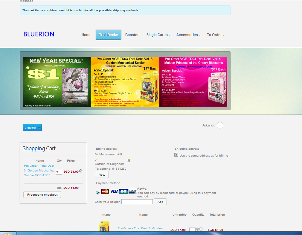

The cart items combined weight is too big for all

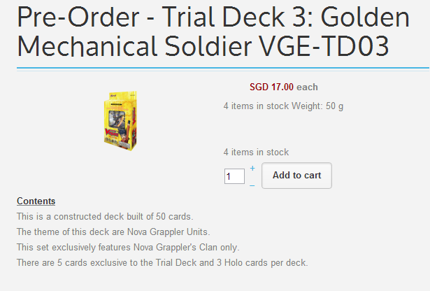

Pre-Order - Trial Deck 3: Golden Mechanical Soldier
50g each

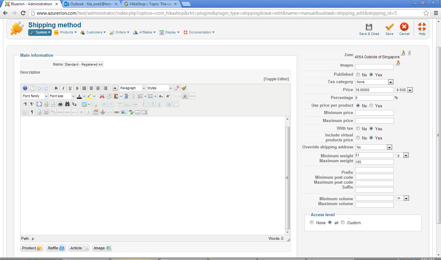

It works fine as far as I can see. On your checkout screenshot, you have 3 products. Each weight 50g so the total is 150g. Your shipping method has restrictions of minimum 51g and maximum 100g, so it's normal that you get that error. I just tried on your website and with only 2 products (100g) the shipping method displays.

Sorry. I sent in the wrong screenshot for shipping.
For product, total of 150g the manual shipping method will no be display.
Please advise

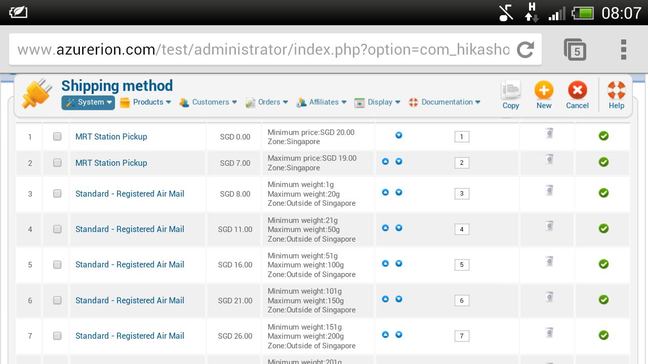

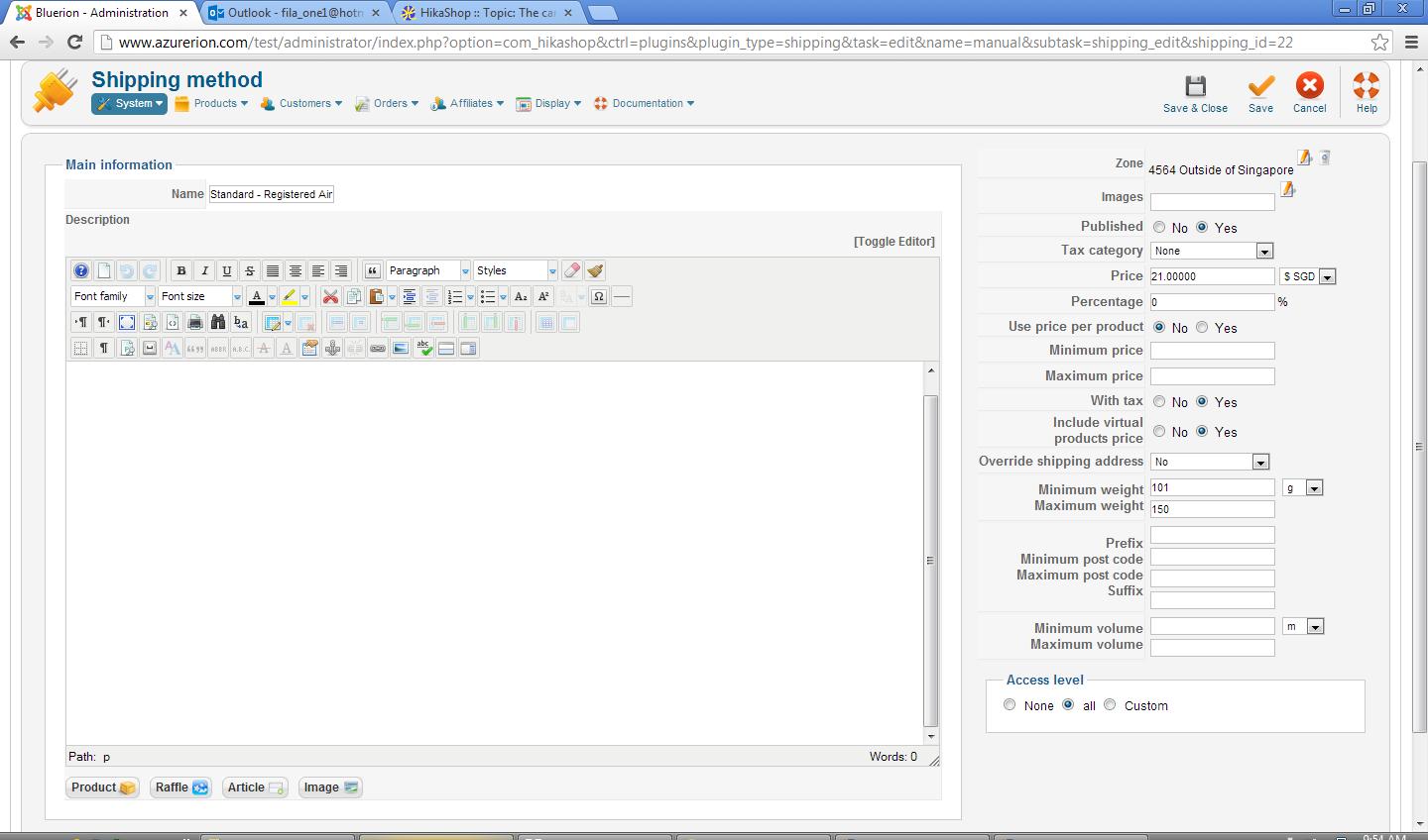

I have attached a working and non-working configuration screenshot

Indeed it acts quite strangely. Could you do some test for me?
For example, I would like to know which method is used and when, so could you try to name your shipping method differently like "air mail - 1", "air mail - 2" and check which one is used for each case?
Also, since you just have 50g products, why don't you set a wider range for your weight limitation? I mean, instead of a range from 101 to 150 you could set from 125 to 175 so you'll be sure two products ordered will be included in this shipping method (but this doesn't explain your problem and it may not fit your needs).

13 years 6 months ago #85580
I have made changes to air mail - 1 (for 51g-100g)and air mail - 2 (for 101g-150g) respectively.

- I have delete and create new shipping method- issue persist
- I have delete and copy an existing shipping method and re-configure the settings - issue persist
- I have change air mail -2 range to 101g - 151g - It works but did not show the other shipping range from 151g - 200g, only show air mail -2
