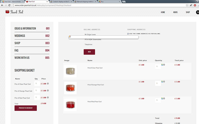

Having a bit of trouble with the checkout page of my site ( www.order.pearlsoil.co.uk ) when you go to the cart after logging in your address displays as it should top left. However instead of the change address button being in the corner it is in a box that floats over the address in a fixed position.
Could you tell me why this is/how to fix it?
Or even better how to change it to make the change address button exactly the same as the new address button and next to it.
I have included a screenshot.
Thanks in advance for any guidance you can give me.

Thanks, It turned out to be bootstrap causing it to display as it was, have got it usable now!

I am having the same issue with the floating address box. I am new to the Joomla/Hikashop world. Is it possible to get a bit more help with how to get rid of the box?
13 years 2 months ago #109003
You have to go in Hikashop > System > Configuration > Display tab, and disable the option "Use bootstrap design".

13 years 2 months ago #109116
Thank you for the reply. The option was already disabled. I have tried turning it on, and then off again, but not visible effect on the site.

13 years 1 month ago #109520
I only have the site on localhost at the moment. I already have a live site and this Joomla/HikaShop version is being developed to replace it.
The code associated with the floating box is:
<a id="hikashop_checkout_billing_address_edit_2" title="Change" class="modal hikashop_checkout_billing_address_edit" rel="{handler: 'iframe', size: {x: 450, y: 480}}" href="/choicestest/index.php/address/edit/redirect-checkout/address_id-2/step-0/type-billing/tmpl-component" onclick="return hikashopEditAddress(this,1,false);"><img alt="Change" src="/choicestest/media/com_hikashop/images/edit.png" border="0"></a>
Does this help?

13 years 1 month ago #109533
Template!
I have been using t3_blank to a very clean look. I have just tried protostar and Beez3 and the box vanishes!
I will investigate other templates.
