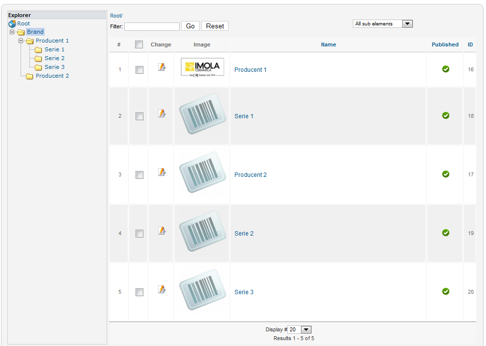

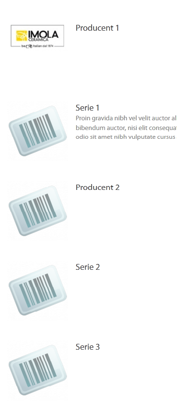

I am trying to get a site to work where we can show a tree with images and description setup as seen on the images
i have
brand 1 with subs series 1, series 2 and series 3
brand 2
when i do my output i get
brand 1
series 1
brand 2
series 2
series 3
what i expect
brand 1
series 1
series 2
series 3
brand 2
I hope this makes sence... see my screenshots.
Any idea what i'm doing wrong ?

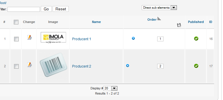

13 years 5 months ago #86414
I think that you should :
- Go to "Hikashop->Products->Brands"
- Use the "Order" option and set the order that you expect for each brand
Hope this will help you.
  • Posts: 171
  • Thank you received: 4
13 years 5 months ago #86416
thanx for the answer, but i can only sort, if i use only main brands, not when showing sub brands.
and no matter, what order i set the subbrands in, it still fails.
the tree structure on hika4.png is how i would like it to look on page too...
see attached screenshots

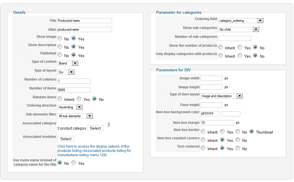

13 years 5 months ago #86432
In you menu options, set the "ordering field" on "category_left".
The following user(s) said Thank You: jesper
  • Posts: 171
13 years 5 months ago #86439
i though i tried that more than once... but that worked.. thanx :)
