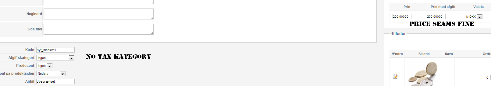

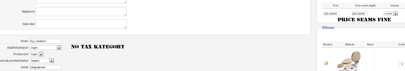

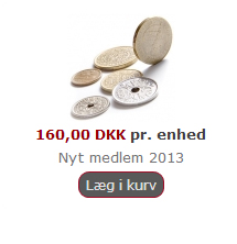

True, you can do that. But my whole problenm is that is NOT the right price that shows up on the front end.....here is how:
In back end price is 100 without tax, and 125 included tax (tax in 25%) BUT if i either show the price without tax, or unpublish the tax rate ect, the price in the frontend shows up at 80....not 100 as its state in the backend. This have been my problem since start.........
