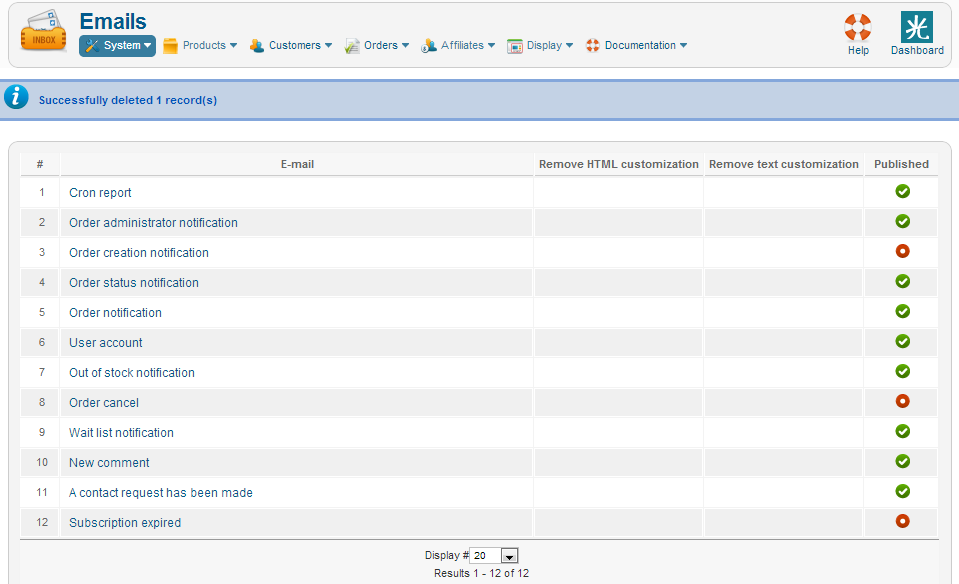

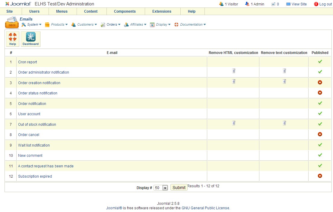

Thank you Jerome. I think I have it set the way I want the emails handled. Here is a screen shot showing that order creation and order status notifications are not published, however I am still getting the order creation email and the order complete email from the site. What am I missing in my configuration?
My goal is to only have an email sent to the administrator when the order status is confirmed and not when it is created.

13 years 7 months ago #87263
So you have to unpublish the mail "order administrator notification".
The payment confirmation email is sent by the payment plugin itself.
