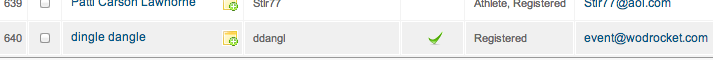

I am trying to ensure users are added to a specific user group after purchase. I have "User Group After Purchase" set to "custom" "athlete" group
but it does not seem to activate as seen here ("registered" but not "Athlete"):

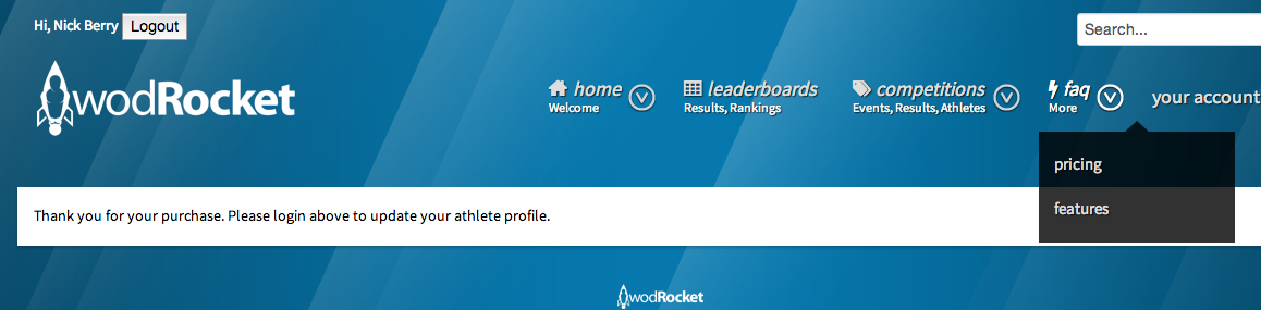

13 years 6 months ago #89146
Thank you. Looks good. The only snag I now run into is for free events like here:
wodrocket.com/index.php?option=com_hikas...emo-winter-throwdown
Despite being logged out, the user still looks to be logged in, which is confusing to the user because the confirm language now says "Thank you for your purchase. Please login above to update your athlete profile."
But "above" looks like they are already logged in. If they were to refresh the page, they would notice the login form.

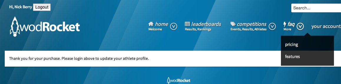

13 years 6 months ago #89236
Hmm.
After creating new account and completing purchase, it still shows user as logged in (even though they are not) as evidenced by refreshing screen.
I have attached the screenshot. Many thanks.
