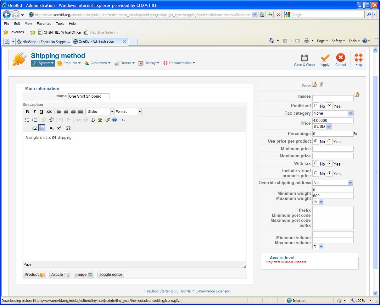

13 years 6 months ago #89007
Here is a screen capture of my shipping method configuration. Each item (Tshirt) is listed as 1lb. I can provide a screen capture of that also though if that would help! I have not set any zone restrictions, unless that's easy to do by accident. :whistle: Thanks!

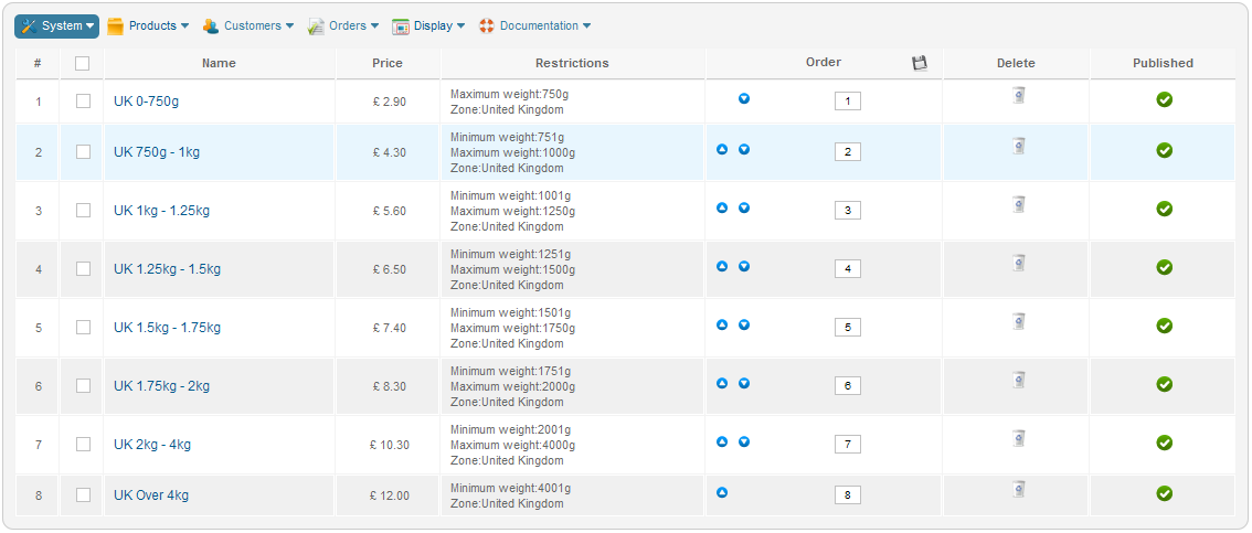

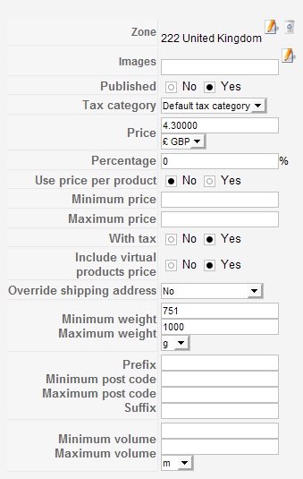

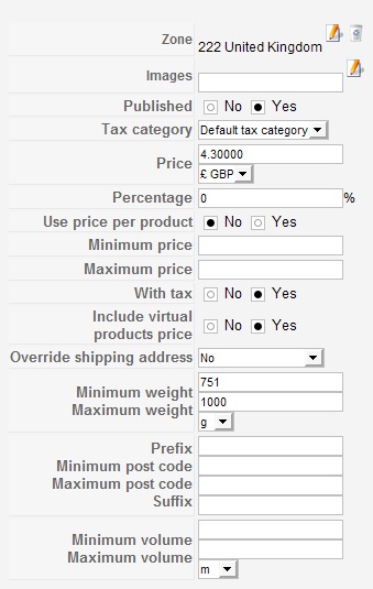

Hi, I am having a similar problem,
having been through all the documentation very carefully, I am baffled as to why i get no shipping methods appear at the checkout, unless i check 'force shipping regardless of weight' and then only one (incorrect!) option appears.
All product weights are specified in grams (the first defined in available weight unit config).
and the customer address is within the zone each shipping method is restricted to.
Any help would be very appreciated :)

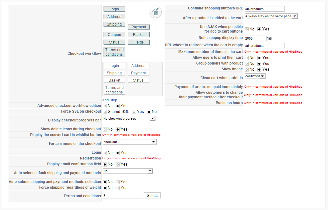

13 years 6 months ago #89125

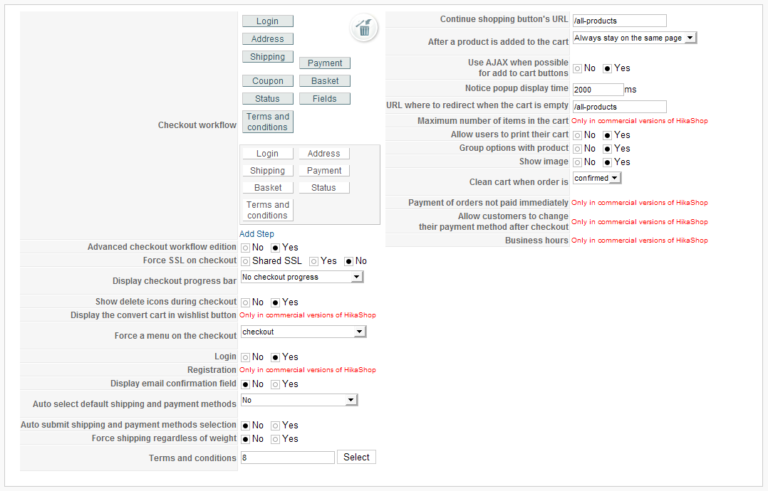

@OneKid: Have your products variants ? If it is, thanks to check the weight of each variants. Could you give us a screenshot of you checkout config.
@IndigoSphere: Because of Zone limitation, the user must enter his address to see the available shipping methods. To not confuse the users, you can create two steps, the first one with login - address - payment and the second with shippin - etc. (It's an example)

  • Posts: 14
13 years 6 months ago #89166
@Xavier Thanks for your assistance, breaking the checkout down into steps is much easier on the eye, I actually didn't clock that this was possible! so thanks for the nudge.
The cause of my problem however was the weights of the product variants.
Maybe it would be useful if product variants in future releases could inherit their dimensions and weight properties from the parent product by default?

  • Posts: 4
13 years 6 months ago #89207
The variants is what got me. I didn't realize that the variants didn't inherit the weight. (I didn't even think to look there, whoops!) Anyway, it seems to work fine now. Thank you!
