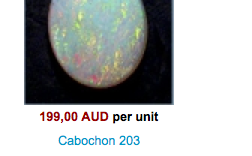

how do I permanently remove "Per Unit" from product pages.

You need to go in the configuration of HikaShop under the tab languages and add the line PER_UNIT="" in the override textarea of your translation file:
