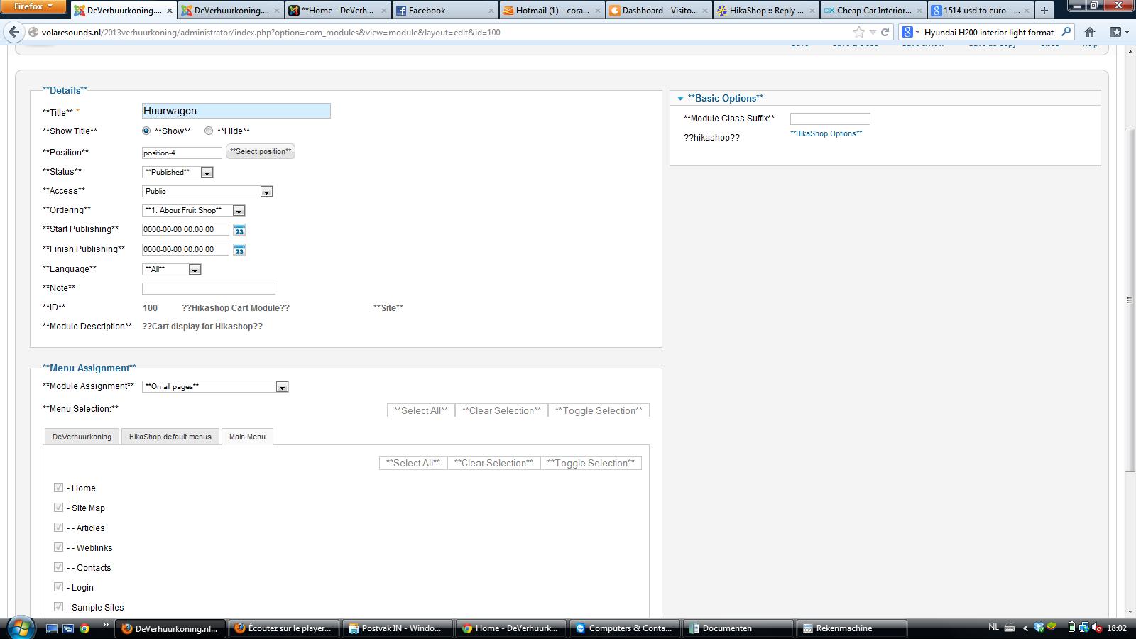

Could you give us a screenshot of the cart configuration ?

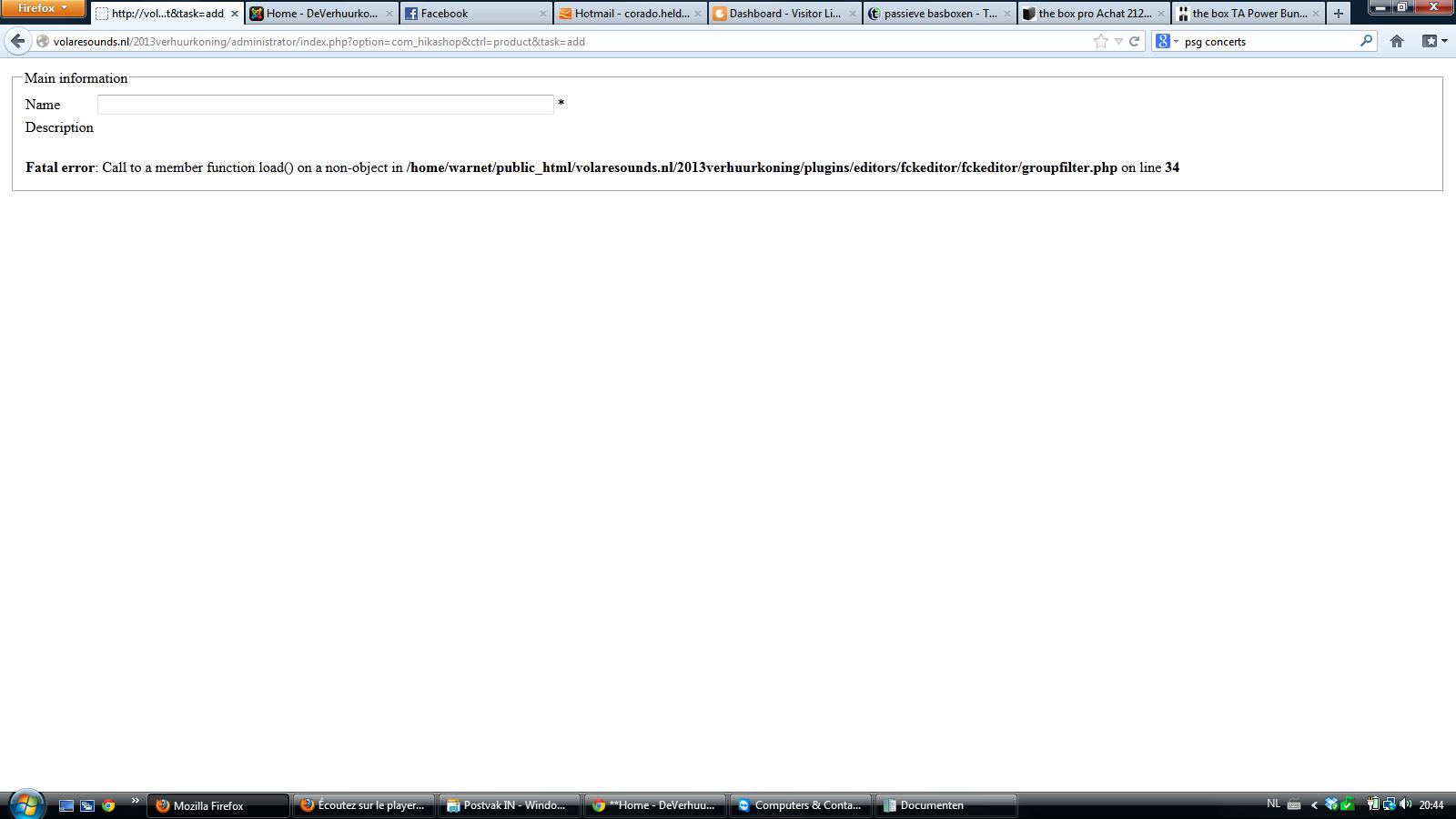

Here i found this problem, (See SS)
I have no idea where this comes from...
  • Posts: 26381
13 years 5 months ago #92253
You can configure another text editor so HikaShop would not more use fckeditor which seams to have a little problem in your website.
In the HikaShop configuration (Main > Main) just change the editor.
The following user(s) said Thank You: corado
  • Posts: 5
13 years 5 months ago #92263
Indeed, thank you! I did installed a different editor.
