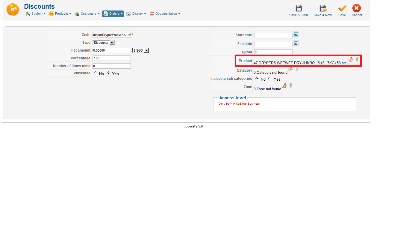

i created a discount and want to tag it to several products however it only applies to the last item even though i have made multiple selection.
is it that the discount can only apply to one product using that option? Any possibility to make it work on a multiple selection?

I made a category promo or whatever you prefer
so all the products in discount I put also in the category promo
then you can select the category in discount

Luppe is right, but note that the discount restrictions are only available through commercial versions of HIkashop.

Understand the category part however will it be messy for administration later?
I am able to link the product to its main category as well as a discount category. But when i want to remove the discount, by deleting product from the discount category, it would delete the product in main category as well right. So i have to manually remove the discount from inside the product configuration..
By the way, how do you restore a accidentally deleted product back to its original location?
13 years 5 months ago #93059
1. If you want to remove/unpublish a discount, you'll just have to do it through "Hikashop->Orders->Discounts" by unpublishing or deleting your discount
2. You'll have to recreate your product, once you delete a product, this product will be removed from all categories.
