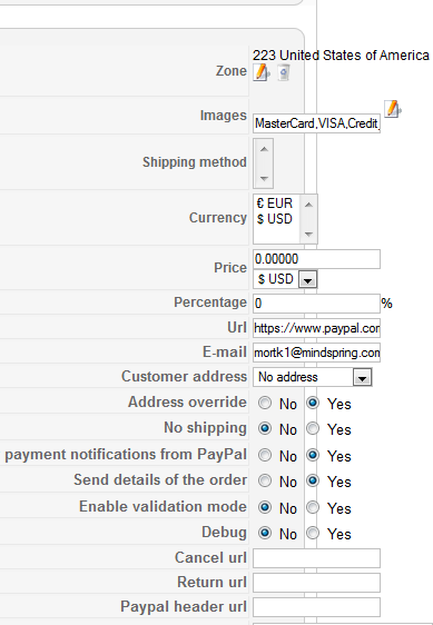

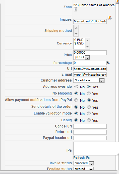

1) Please see the attached screenshot of my PayPal configuration. Once again, the 9% California tax that I have set up does not appear in the PayPal invoice window.

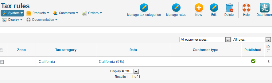

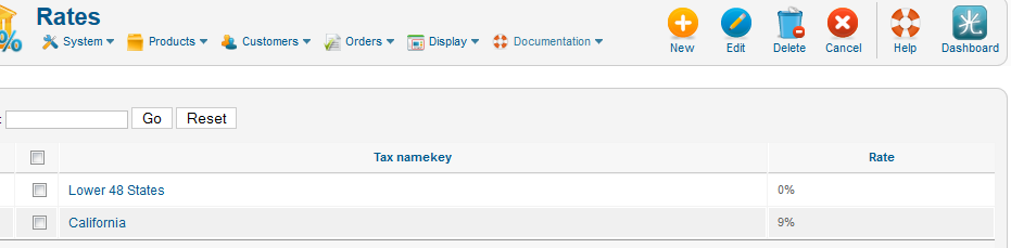

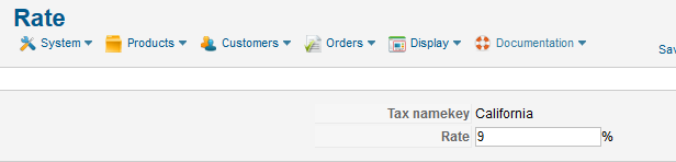

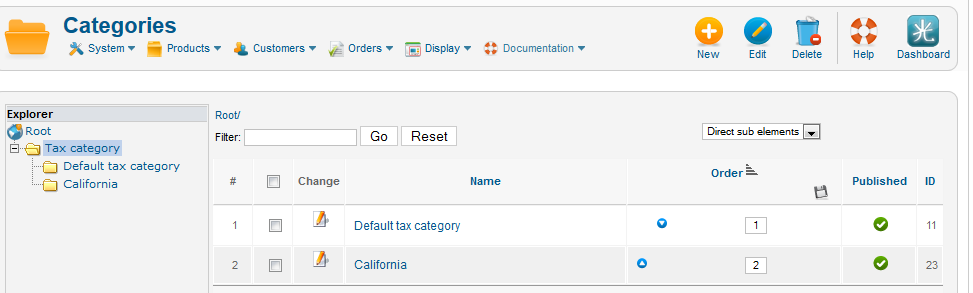

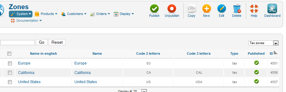

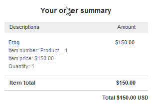

1) I made the change that you suggested but the 9% California tax that I need to charge still does not appear on the PayPal Order Summary or in the purchase confirmations that are emailed to me. I have attached 6 files to show all my tax-related settings. Please have a look to see if you can find the problem. Thanks!

13 years 5 months ago #93599
It's working fine with me, are you sure that you switch the paypal "Send details of the order" option to YES ?
Last edit: 13 years 5 months ago by Mohamed Thelji.

Hi Mohamed,
Attached is a screenshot of my PayPal settings...as you can see, "Send details of the order" option is set to YES.
You said that it's working fine for you...I do not understand this. Did you register/login at my site with a California address and try to make a purchase?
I have registered with my California address and the 9% tax does not appear when I check out.
If I take the next step and I go to buy the item in PayPal, the tax does not appear on the PayPal order summary.
If it's working for you, why is it not working for me?
You now have screen shots for all my settings...what am I missing?
How can I get it to work for me?
Mort

13 years 4 months ago #97739
Sorry Mohamed wasn't there since 3 weeks.
Is your problem solved ? If not, can you update HikaShop and try again ? (the latest version is the 2.1.1).
The PayPal plugin send the order full price, so paypal should receive the price with tax. The option "Send details of the order" is not very related on the taxes.
It just send all the prices.
