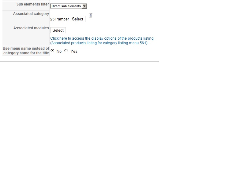

1st question:
how do i select and use an associated module? (I just want to set a generic associated module to use in all my product menu)
For example i want to change the current associated module 1 to a new associated module 2
when i press the select button,
it gives a list of associated menu but when i click on the link of the associated module 2,
it launch the associated menu setting. After saving, the current associated menu 1 is still assigned.

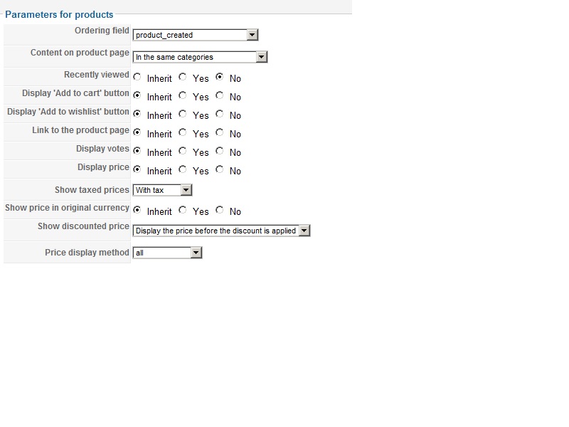

2nd question:
Where is the configuation that affects the parameter of product in hikashop options? In the hikashop configuration (product; default parameter for product), the parameters does not match. the show tax dropdown box is not present.
Derrick
13 years 6 months ago #93878
In the associated module options, you have to set a "product category" so you can't use a generic associated module, else it will always display the same products.
The main show tax option is a global option, you can find it in Configuration > Main > Taxes > "Detailed tax display".
