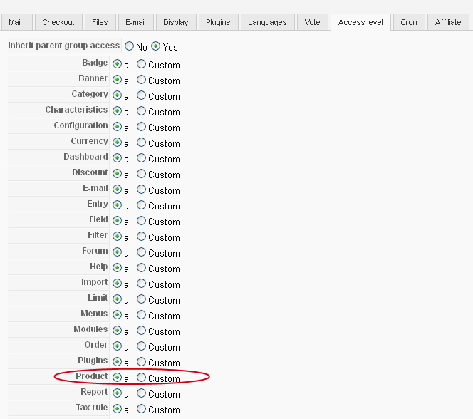

How do I give access to HikaShop please. I'm using Joomla's ACL to give access to a user. With other components I just have to click on "Options" and change the access on the component to "Allowed".
With HikaShop I don't know how to do that. When I go to System > Access Level and click on "Product" all the options are checked but the user cannot see the component.

And as I mentioned below, I went to the Access Level but the user cannot see the shop. I'm not sure what I could have messed :(

As I mentioned above, when I go to System > Access Level and click on "Product" all the options are checked but the user cannot see the component.
I set Inherit parent group access to YES. And I click "Custom" next to Product but then it goes back to "ALL" when I click on Save.

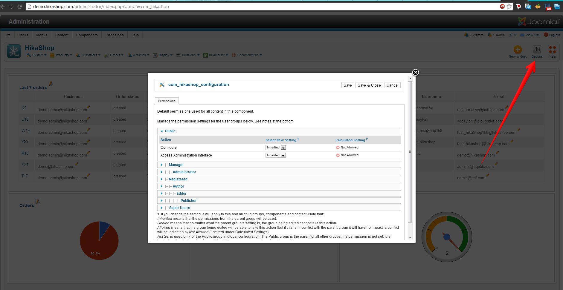

13 years 4 months ago #97414
Like the other components, you can click on "options" to set the access to the whole component:

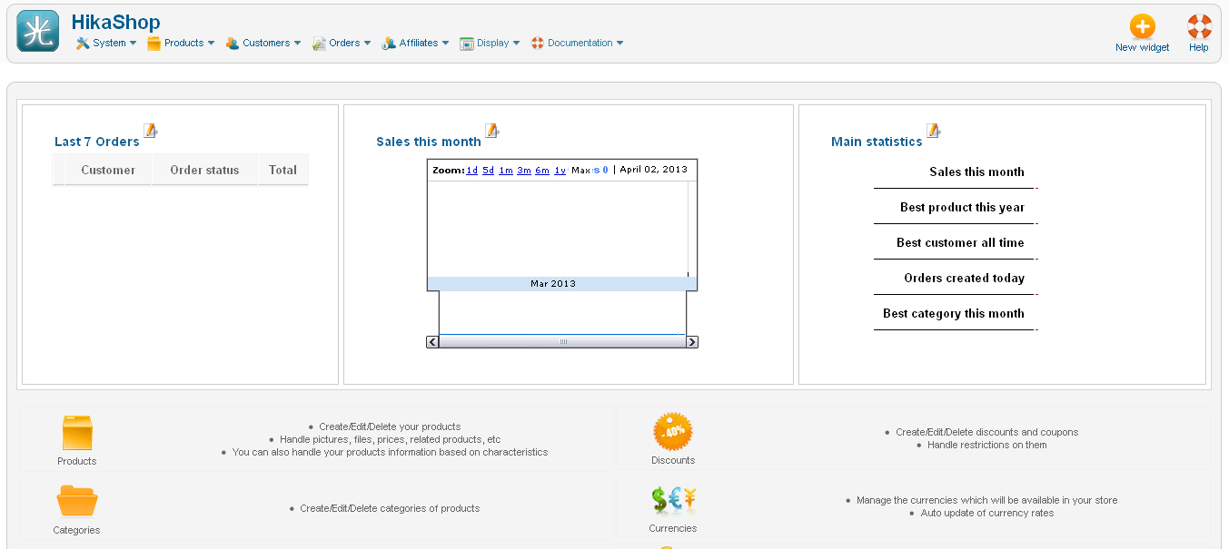

13 years 4 months ago #97450
Nicolas, I don't see that option from that or any other screen. I only see "New Widget" and "Help". Please see attached pic.
  • Posts: 26381
13 years 4 months ago #97467
I guess you should be logged with a super admin user in the Joomla backend.
The popup is called by HikaShop but it's a Joomla feature which is called and, if your account does not have the right to edit the access levels, the button would not be displayed.
  • Posts: 966
  • Thank you received: 11
13 years 4 months ago #97471
I am the super admin/user. I am logged in from the backend. I am able to see that option for ALL the other components. I just don't see it for this one.
Thanks!!
  • Posts: 966
13 years 4 months ago #97478
