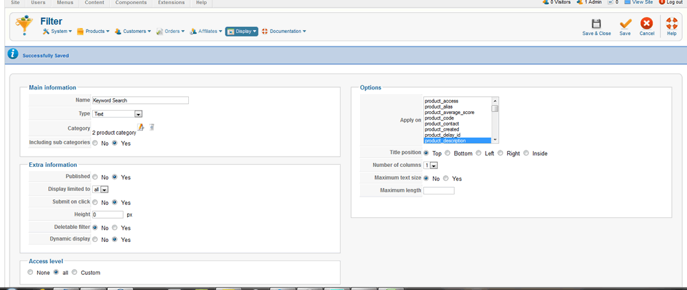

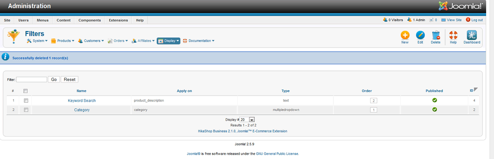

  • Posts: 26
13 years 3 months ago #101230
Hi Xavier, thanks for getting back to me. I've attached 2 screenshots for you of my setup.
The main problem is just getting the filter module to display properly - see dubai.directrouter.com/~uwkhsvka/index.p...services/online-shop
and then the filters 'double up' and won't display any search results on this page - dubai.directrouter.com/~uwkhsvka/index.p...ting/product/listing
I must be doing something fundamentally wrong I'm afraid
JR
13 years 3 months ago #101380
For the 1st problem, it's a css issue, so you can follow this tutorial to try to correct the problem.
www.hikashop.com/fr/support/documentatio...ize-the-display.html
The second problem, is probably due to the module 121, try to disable it.
