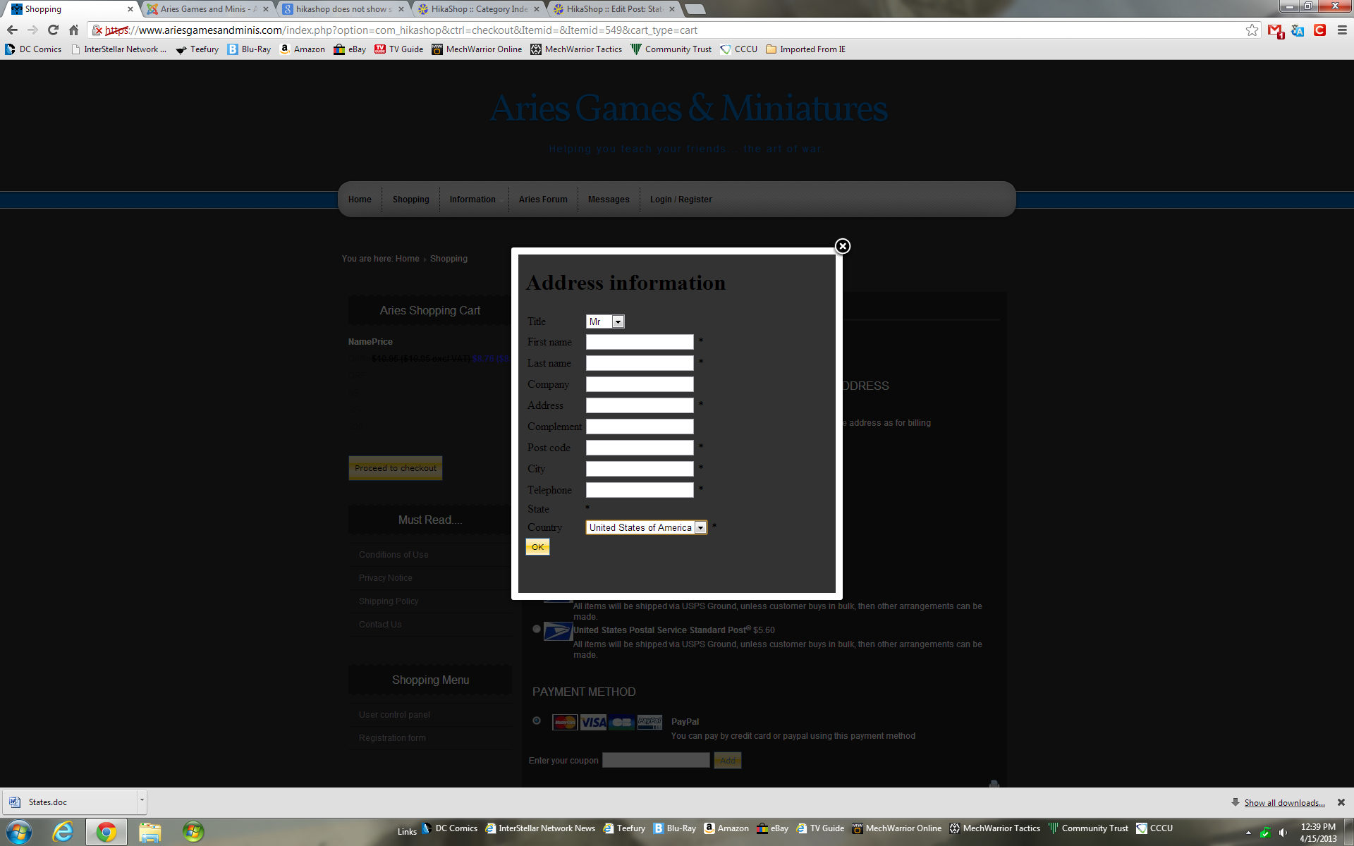

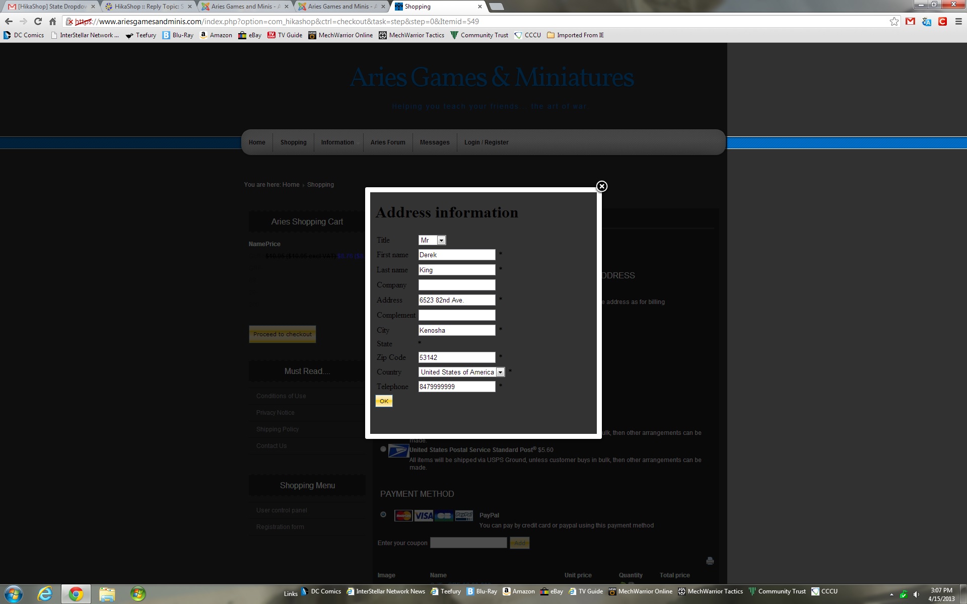

For some reason during the checkout screen, the state drop-down will not open when selecting United States as the country. I've checked the Zones list, and all states as well as the country listing for USA are enabled. How can I fix this...please help...thanks!

If you change the country to another country and then to "united states", do you have a drop-down ?
Is "united states" your default country ?
You could have a wrong default value in your "country" address custom field.
By editing it and saving it, it would save correctly the default country and the state drop-down would load the right content.

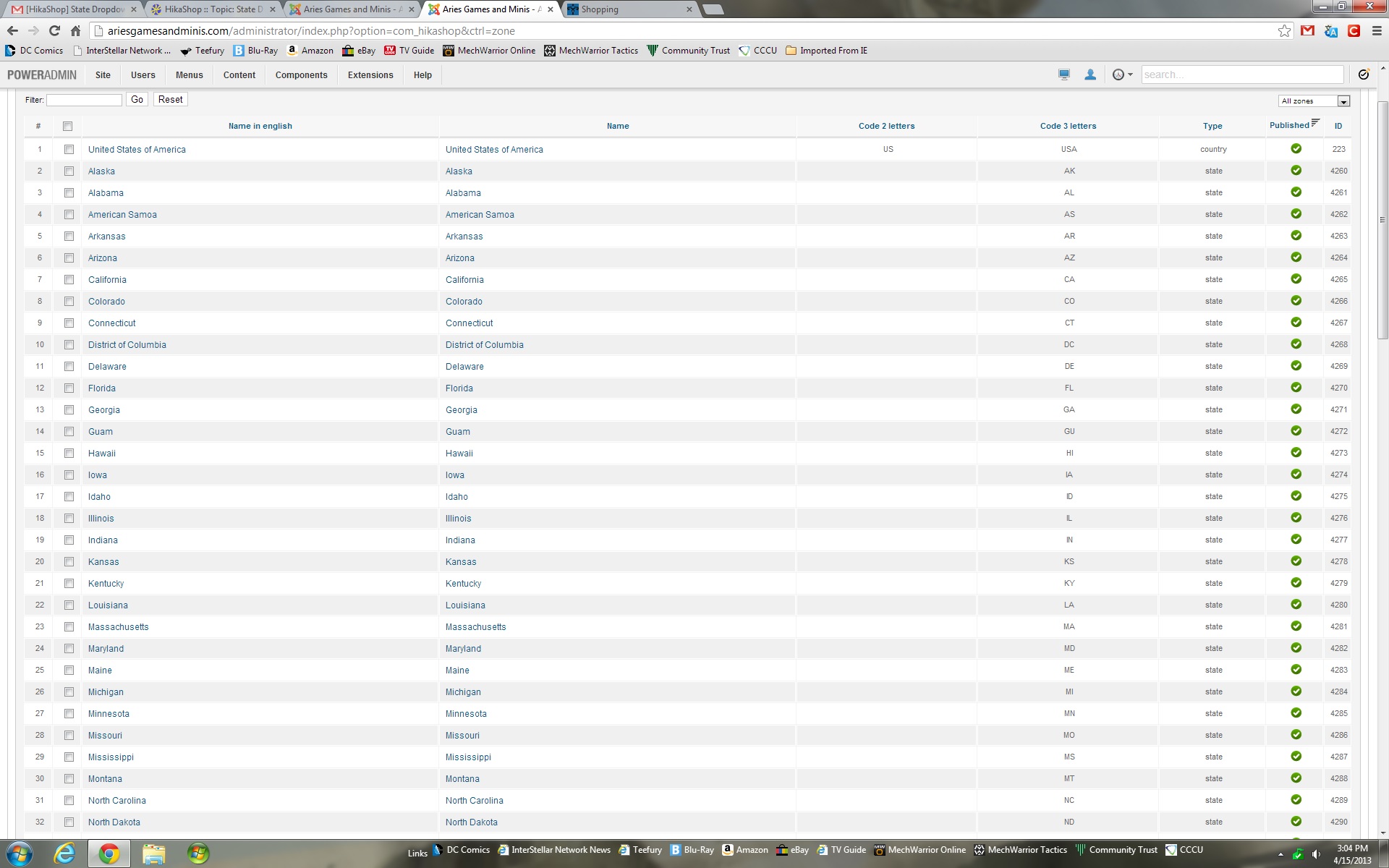

I did try removing everything from the "zones" section of Hikashop, then only enabling the United Stated as the country. That didn't work. So I enabled all 50 states, and again...that didn't work.

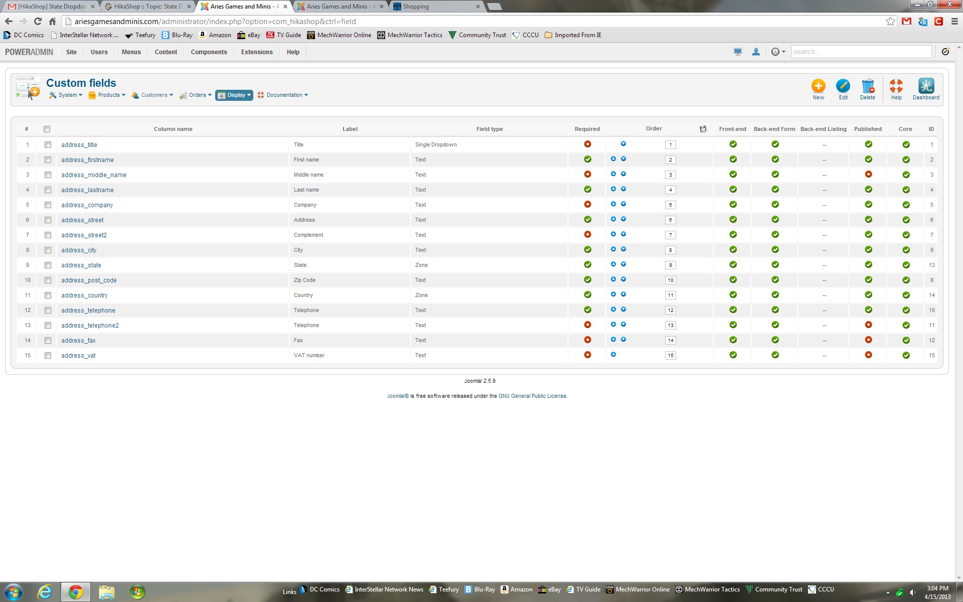

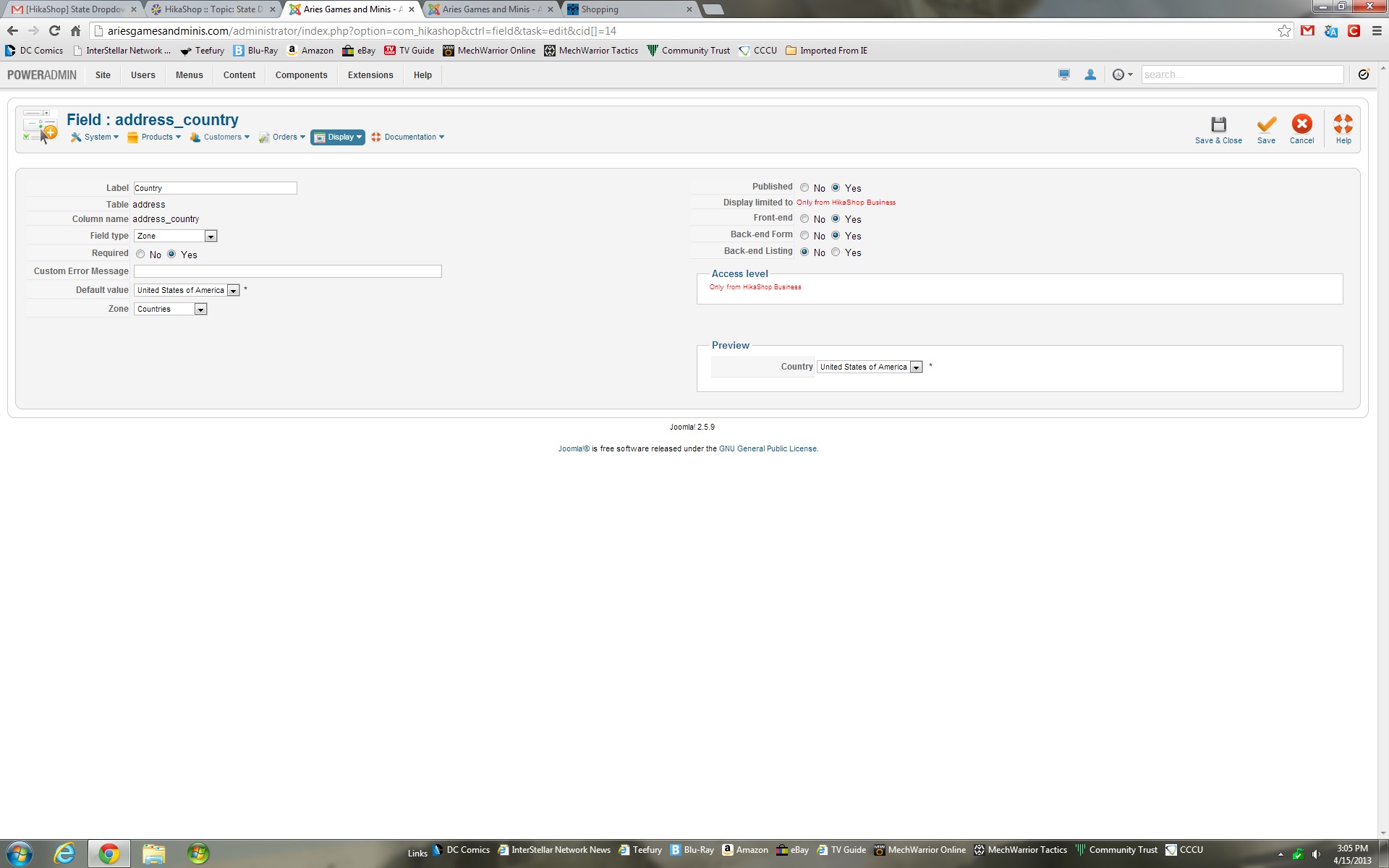

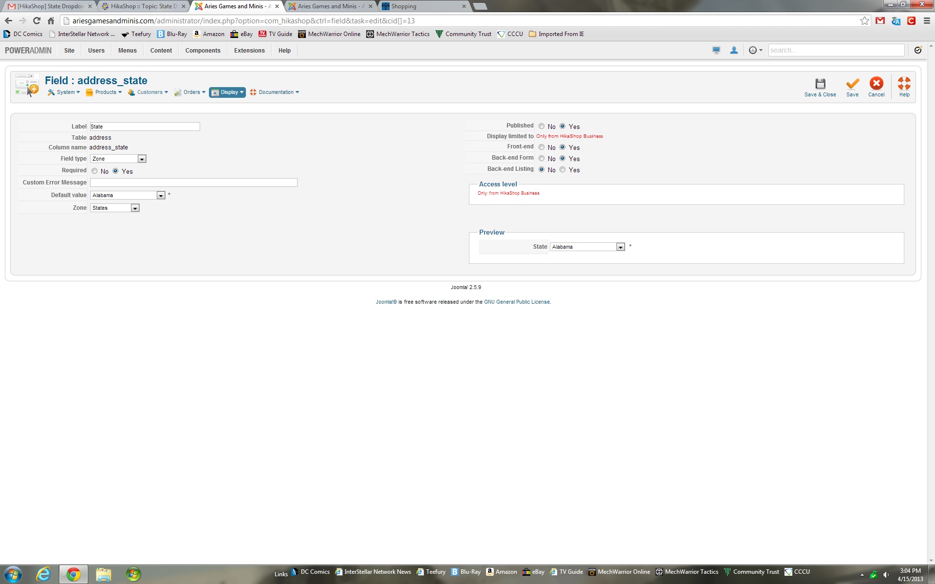

Ok...I found what you asked me to...and they are already set as default. I've attached some screen shots I think may help...
I've enabled & disabled all the items in the images...and still my states do not show up.

13 years 4 months ago #99252
Did you re-save the country custom field ?

13 years 4 months ago #99266
Got it !
Your website running on HTTPS but the webcall which retreive the content of the dropdown is done on HTTP (without SSL).
So there is a restriction made by the browser: "Origin https://******* is not allowed by Access-Control-Allow-Origin.".
I think it's a problem with Joomla "JURI::base()" function which returns a http and not a https url.
I have open a bug report on it in order to reproduce it on our local websites.

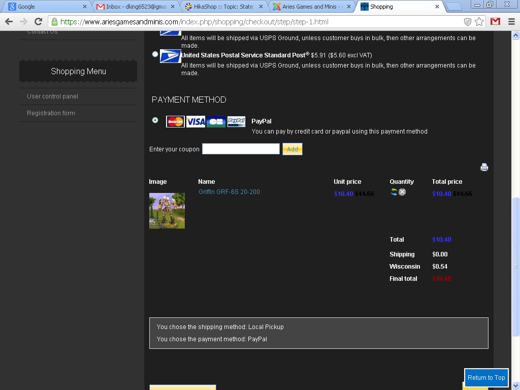

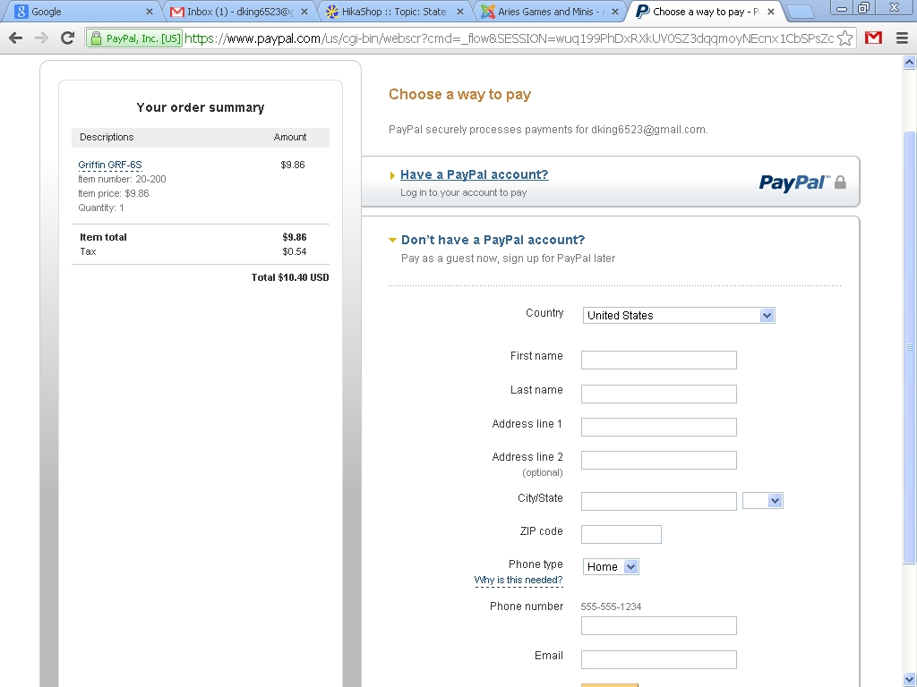

Ok...I've done something wrong, but I don't know how to correct it. I tried to make an order for myself to make sure it would charge tax all the way to the PayPal screen. My tax rate would be 5.5%...so we will use that in the example below.
Problem #1...With the item in my cart at $10.40, my shipping address correctly entered along with Local Pickup selected for shipping, tax is coming out to $0.54 when it should be $0.58. (Image #1)
Problem #2...When I go to pay through PayPal, it is showing the item at $9.86...not $10.40, but it did transfer over the (incorrect) tax rate of $0.54.
How do I fix both. If you want me to start a new thread...I will.
Last edit: 13 years 3 months ago by Dragon41673.
  • Posts: 713
  • Thank you received: 37
13 years 3 months ago #102241
Ok...I figured out Problem #2. It was crediting the tax as it was set for local pickup, so after I made that not an option, tax was being calculated properly.
