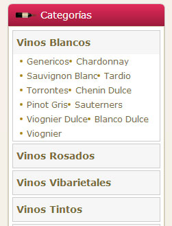

Hello.
I have a problem with the accordion vertical menu module of HikaShop.T
he subcategories are all together and I want each category is displayed one per line.
Deputy capture the problem.
Is there any way to fix it?T
hank you very much from now.

I guess that is not a problem with the accordion vertical menu but with one of your CSS rules.
The content of the accordion is a list made with "ul / li" and I think you have a CSS rule which change the vertical listing of this "ul / li" into a horizontal listing (by adding a "float: left;").
You have to add a new specific rule for the accordion in order to remove the "float: left" for the "ul / li" of the accordion (using the unique id of the main div of the module).

In your custom CSS file, you have the rule:
.hikashop_category_list_item, .hikashop_product_list_item{
	float:left;
By removing it, the list would be displayed vertically.

Thank you very much it worked to perfection!
