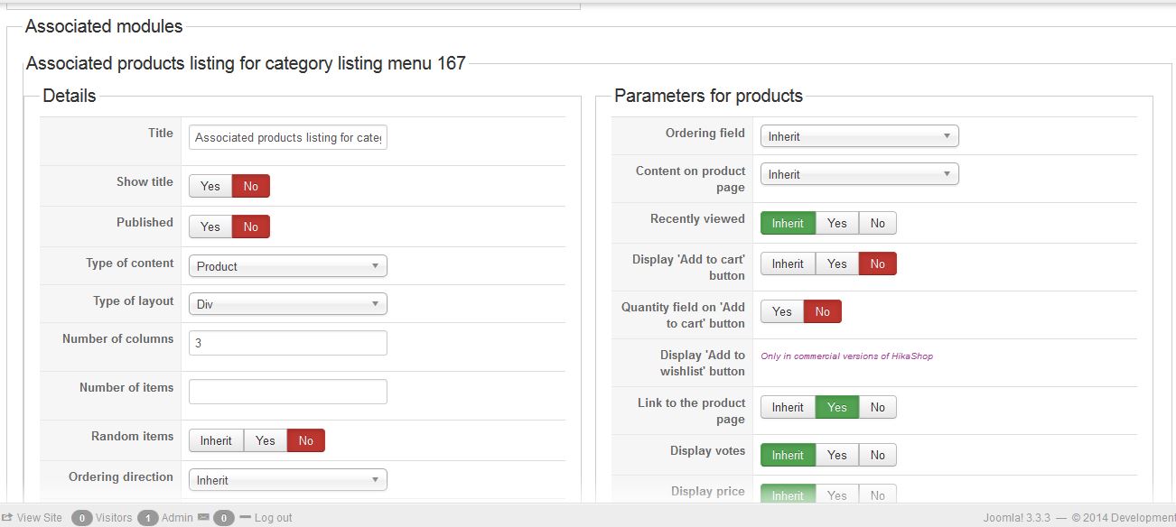

I've read a few posts about this issue and there seems to be a 'show add to cart button' feature that I don't have. I seriously cannot find it. Please let me know how to remove that from the category view. Thanks
13 years 3 months ago #101755

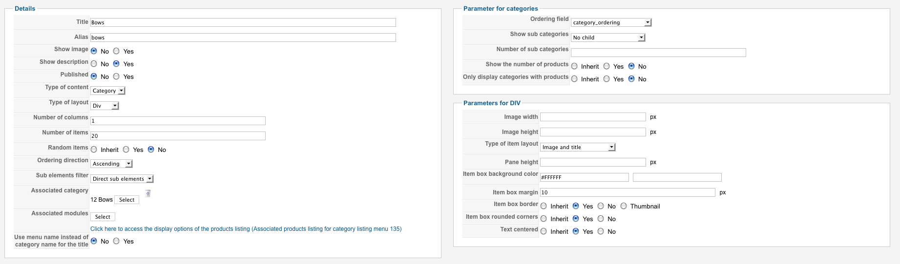

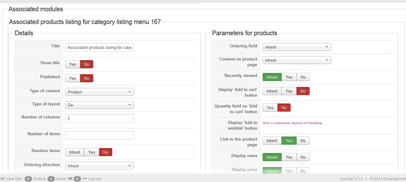

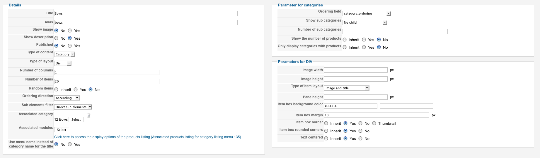

You'll just have to :
- Edit your category listing content menu through "Hikashop->Display->Content Menus->'Your Content Menu'"
- click on the "Associated modules" link
- Then set the "Display 'Add to cart' button" option to NO.
Hope this will help you a little.

Am I missing something? I can't find the option
13 years 3 months ago #102090
As I told you, you'll find it through your category listing associated module, you'll just have to click on the "associated module" option's link :).
  • Posts: 4
13 years 3 months ago #102094
ah! got it! Thanks!

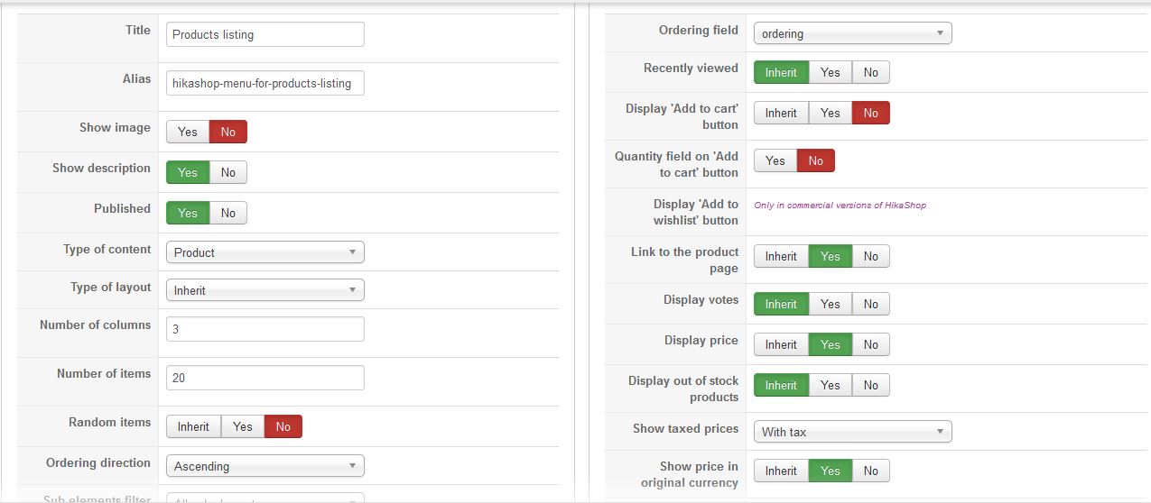

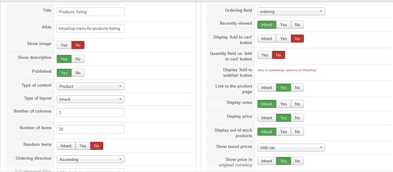

Hi there,
I cannot turn off the 'add to cart' button on my products listing (not product page, but product listings page).
I have gone to Display > Content Menus > 'Products Listing' and from there disabled 'Add to cart'. But on front end the 'add the cart' button still displays. Please see attached. I cannot work out where I am going wrong. Cam you have a look?
  • Posts: 26381
11 years 11 months ago #167532
I guess you're editing the wrong menu.
In your website, the menu you are using have the id 106, not 167.
If you look at the "alias" of your menu, you will see that you are not using this alias while browsing your website.
