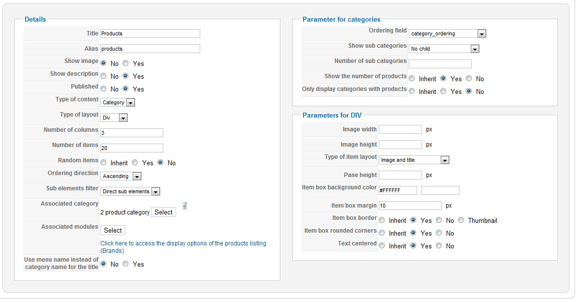

13 years 3 months ago #102685
I think that the associated module is not the correct one.
Thanks to give us a screenshot of the associated module configuration (bottom - left of the current screenshot)
