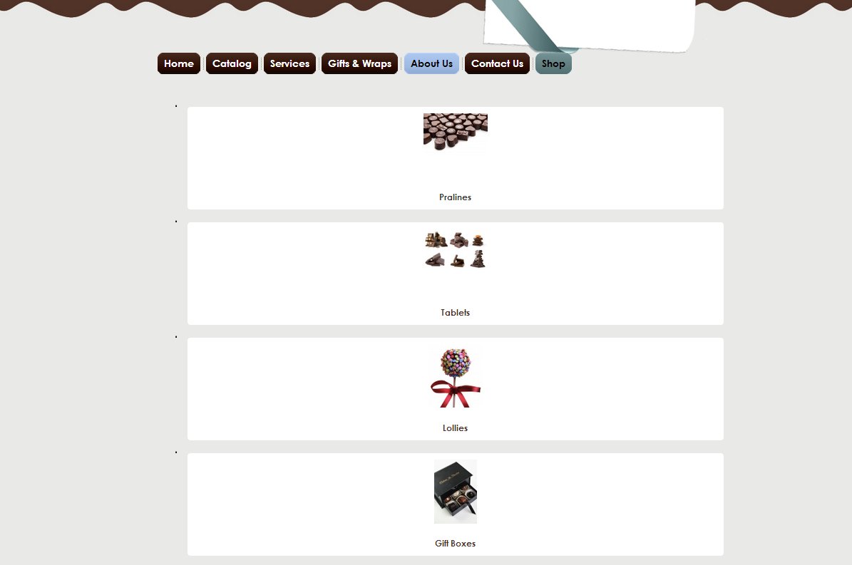

I really like the module so far but for some reason I can't get any thing to display in div.
Not the category and not the products.
I only get a list display of the items one on top of the other.
Pictures are displayed and so does the title but no div mode (see sample image attached-
Could it be template related?
Is there a go around?
Thanks in advance,
Guy.

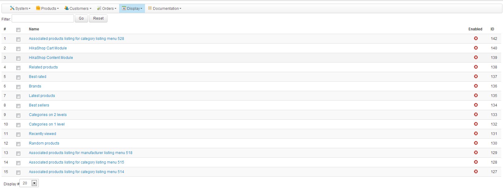

Can you provide a screenshot of your HikaShop module configuration ?
(HikaShop > Display > Content Modules)
  • Posts: 3
13 years 3 months ago #103436
There you go:
  • Posts: 86050
  • Thank you received: 14178
13 years 3 months ago #103439
Please turn off the "use bootstrap design" option of the configuration and it will display fine.
