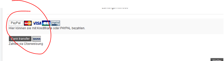

Hi, can i only choose the payment by buttons? are there any alternatives?
when the step "payment" appear there are two options. at the beginning one option is chosen. i think its confusing.. can i change it?

You have the HikaShop option which auto select the payment method in the checkout.
After that, if you don't want to use the bootstrap design, you can deactivate the option (but it will affect the entire site) or you can override the "checkout | payment" view in order to have you own design.
The payment select is not really using buttons, it is using radio with a "btn" class style.

Where i can choose the design? cant find the option?
it is not possibile without great php skills..?

The option is called "Use bootstrap design":
www.hikashop.com/en/support/documentatio...html#display_general
Modifying a view for this modification does not require great php skills.
You can just edit the "checkout | payment" view and replace:
if(!HIKASHOP_RESPONSIVE) {
By
if(true) {
In order to switch to the non-bootstrap design for this specific view.
