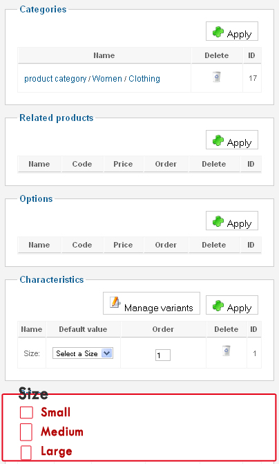

What is the best way to do this. I'm going to try to explain the best way I can.
The client would like to easily add sizes or colour, etc... when adding a product. So she says instead of adding the size or colour in the description if there is a way to add it similar to how Characteristics are added except these won't have characteristics.
Instead it could be like a checkbox or a dropdown, on the right as per the attached, where you select the size that you are adding for that particular product.
I checked out the "Options" option but I don't see how that will work in this case. So would this have to be a "Custom Field" that is added in the views? And, can it be added on the right as per the attached example?
Thank you!!

Yes, some product custom field could be useful for your needs.
In the backend, your client can select the size or colors and in the front-end, you can display them like you want, by overriding the product page.
You can no display the custom field in the "show_block_custom_main" (filtering on $fieldname) and display them in another place in the page (or with a different look).

No no no, it's a lot more complicated than just copy/paste. It requires a strong programing skill to modify the code to be able to do that since you don't just want to add checkboxes for the product but you also want that the checkboxes control the available variants for the product (that's the hard part).
Just adding the custom field will display what you want on the product edition page but it won't change the available variants for the product.
I would recommend to hire a developer for that.
