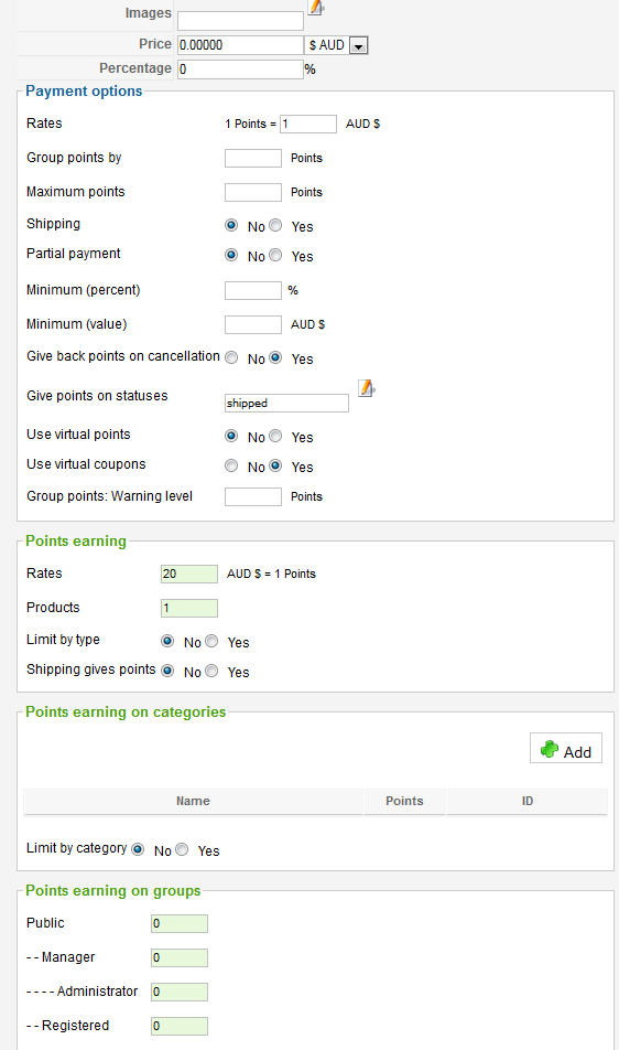

I've tried changing the "shipping" option in alphauserpoints payment method from "yes" to "no" and back.
Currently all this does - is it either incorporates the shipping in the amount of points deducted - or it fully ignores shipping and the customer gets their product without paying anything for shipping at all.

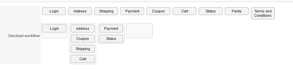

I've attached screenshots of my shopping cart flow and also the alphauserpoints configuration.
I'd like the cart to work as follows:
1) Customer earns "x" points
2) Customer chooses to pay with points
3) Customer also pays for shipping via paypal/bank deposit
This is how it currently works:
3) (shipping on) Customer pays for product + shipping with points
4) (shipping off) customer pays for product and gets free shipping

In the current version of the plugin, the "virtual coupon" mode is not compatible with the "shipping" one.
It is something we want to fix but it require a important refactoring of the plugin.
Best regards,
