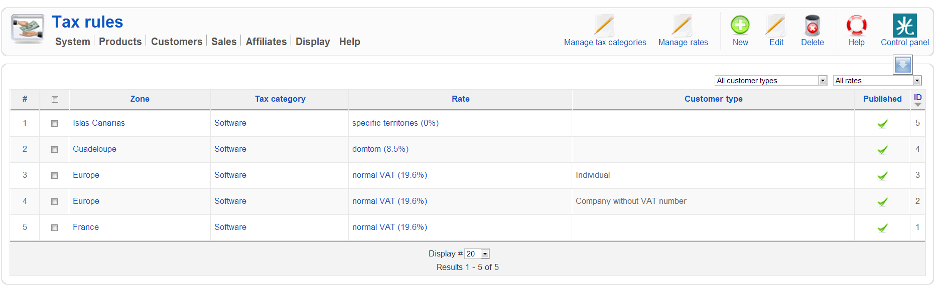

Here is an example of the tax rules that we have on our website:
Simply remove the Guadeloupe tax rule and change the France zone to Netherlands and that will be all you need to configure for your tax rules.
You can use the default tax category as it is already selected by default in your products. There is no need to create a "software" tax category on your end.
And finally, in the "main tax zone" of your configuration, you can select the Netherlands instead of the default one.

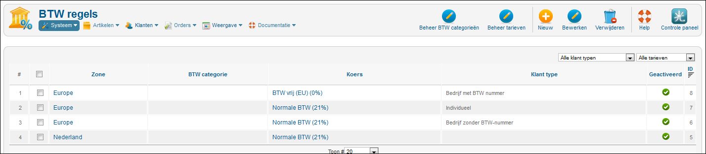

Main tax zone is set to The Netherlands and i 'copied' the entries of your screenshot. I only added a 0% rule (as your islas canarias rule).

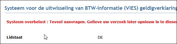

I can't test it properly now, because the VIES server is busy... :S

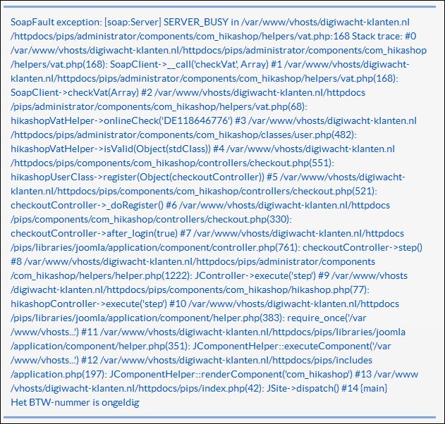

That brings me to another point. The error that returns is a huge amount of text, maybe there can be a nicer error displayed, or when online check is not possible, a format check will be assumed.

You don't need to 0% rule. If there is no rule, the taxes will be 0 anyway.
If you want a soft fallback, you can change the lines:
$result = false;
to:
return true;
in the file administrator/components/com_hikashop/helpers/vat.php and the system will skip the online VAT check and only do a regex check when the online server is unavailable.
