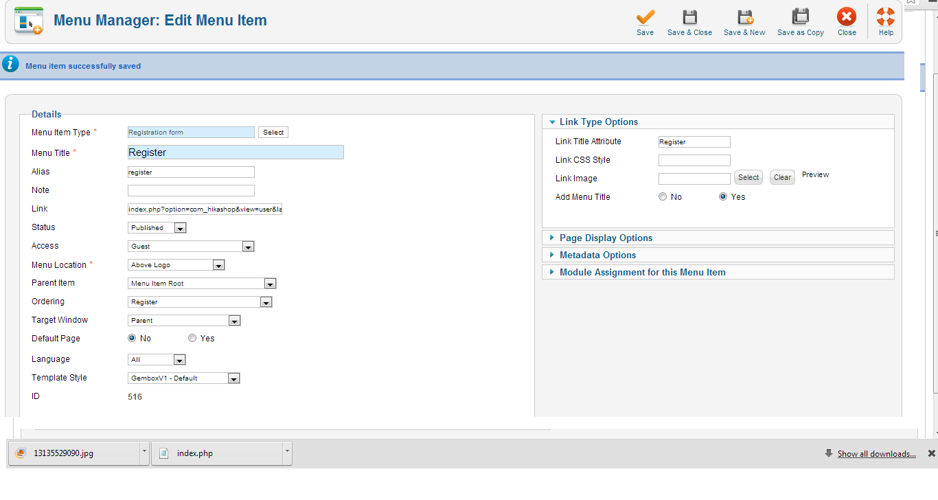

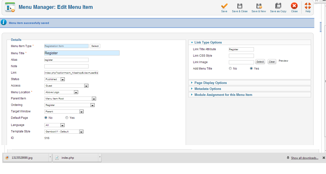

  • Posts: 71
13 years 2 months ago #107000
here with, i had attached the screenshot.
Thanks for your help.
