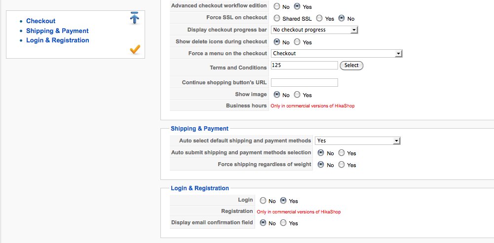

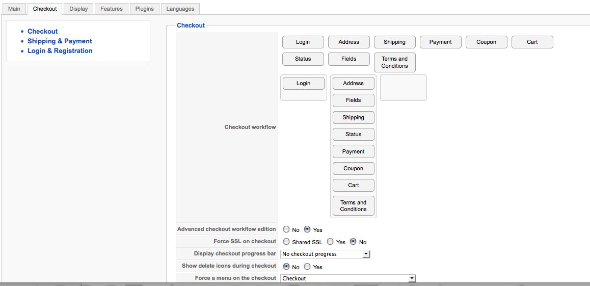

13 years 2 months ago #109228
Hi Mohamed,
sure, see attached the screenshots.
I used the configuration you gave me yesterday (on my question regarding coupons), I just separated the login from the other steps and added the terms, because we need them.
Thanks,
Julia

We were not able to reproduce the problem on your website. However, we found that the "force a menu on checkout" option was not configured properly. It was set to redirect to the same page via a menu of the type "url". That's probably why it was causing the redirect in some instances.
I've set it back to the default "none" and that should avoid any possible loops on the checkout and thus that error.
