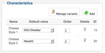

How can I add a character string between the display of variants on the product page and in the cart? For example:
Product Name: Variant1 Variant2
becomes
Product Name: Variant1 with Variant2
Thanks.
Dave

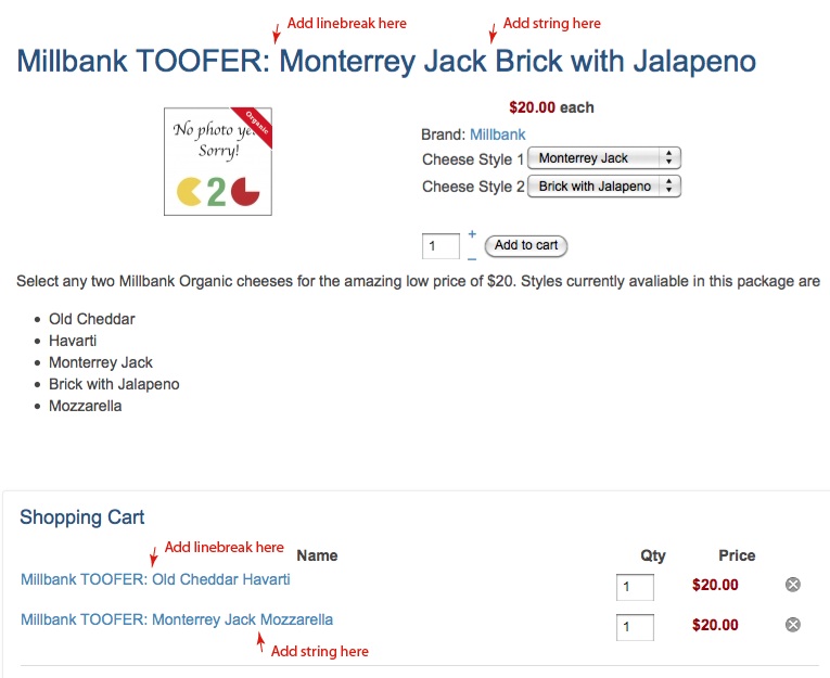

13 years 1 month ago #110092
Can you show me exactly where do you want to add this string through some screenshots ?
  • Posts: 55
  • Thank you received: 4
13 years 1 month ago #110102
Here are some shots. I'm not sure exactly which string I will use, but something like 'and' or '/'. Also since these combinations are long, is it also possible to out the two variants and the separator string on the line below the product name? Is it possible that one modification will affect both product display and cart display?

13 years 1 month ago #110140
For the line break, you can simply add a translation override like that:
HIKA_VARIANT_SEPARATOR=":<br/>"
You can do that via the Languages tab of the configuration.
For a character between each variant, you can open the table hikashop_config of your database via phpmyadmin and add an entry with the namekey characteristics_values_separator and the value being the text you want between each variant.

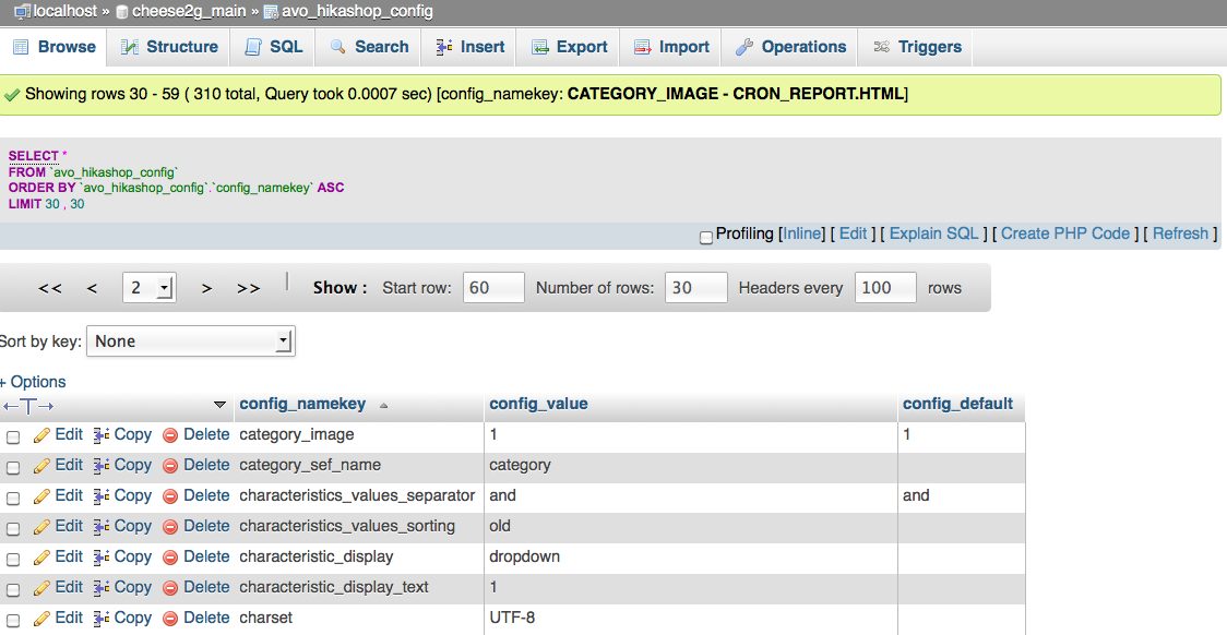

13 years 1 month ago #110273
Thanks Nicolas. The linebreak worked no problem, but not the string separator. I've added to the table as you suggested (see image). Does the entry need quotes, like this: 'and'?

  • Posts: 86049
  • Thank you received: 14177
13 years 1 month ago #110277
That's looks ok.
Are you using a recent version of HikaShop ?
Also please make sure that there is no spacing character at the end of the config_namekey value or the system won't be able to find it.
Also, if you have some caching activated on your website, please make sure that you flush it.
  • Posts: 55
13 years 1 month ago #110281
Using HikaShop 2.1.3. Checked for spaces in table. Cleared cache... still not showing the additional string.
Dave
  • Posts: 86049
13 years 1 month ago #110301
It's working fine on our end.
We'll have to look at that directly on your website as there must be something you're missing on your end.
Either it's not the good database you're editing, or something because it has to work.
