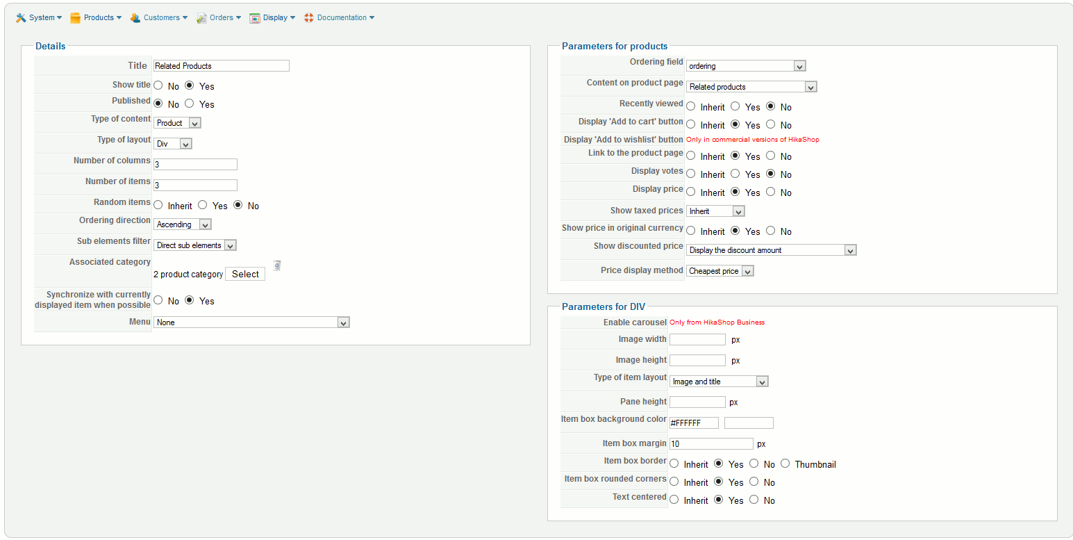

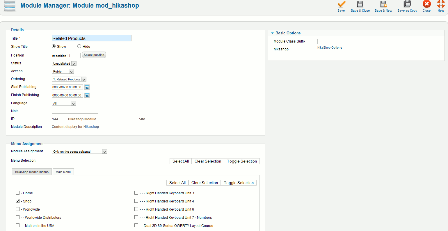

I've attached some config screenshots. Please can anyone suggest what could be wrong or if there's anything I can check?

Thank you for your reply. Yes, it is a valid module position. Also I did follow the step shown (please see screenshots).

As I can see in the second screenshot, the plugin "Related products" is unpublished.

1. Create a new module of the type "HikaShop content module" via the joomla modules manager and leave it unpublished in the joomla options of the module.
Even if I do publish the module, it still does not display. I have tried different template module positions.
