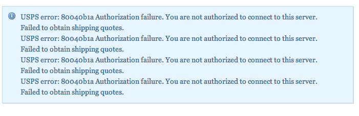

13 years 2 months ago #110882
I'm also getting the "USPS error: 80040b1a Authorization failure. You are not authorized to connect to this server.
Failed to obtain shipping quotes.
" error when I do it with your account, but it's working fine with my account, I think that you should contact USPS about this issue.

I contacted USPS and here’s their response - however, I don’t understand what they’re telling me to do:
The Authorization Failure you have been getting is more than likely the result of your Web Tools account .... not having been on our Production Server yet. I have updated your profile to allow you access.
1. The Production Server URL is: production.shippingapis.com . For APIs calling the secure server, the URL is secure.shippingapis.com .
2. There is a line of code that refers to "shippingapitest.dll". You'll need to remove the word "test".
Since you are using pre-developed software, should you require additional assistance in completing the activation process please contact the developer directly. I apologize; however, the USPS does not maintain information on configuring third party shopping cart software.
Permissions for verifying addresses and creating labels are added separately. Should you have an interest in obtaining these permissions please respond to this email and I will be happy to assist you. If you are uncertain as to whether your cart supports this functionality, please contact your third party software provider for clarification.
13 years 2 months ago #111017
It seems like they updated your USPS account, so I tested it on my end and it seems to be working fine, can you test it through your website ?
