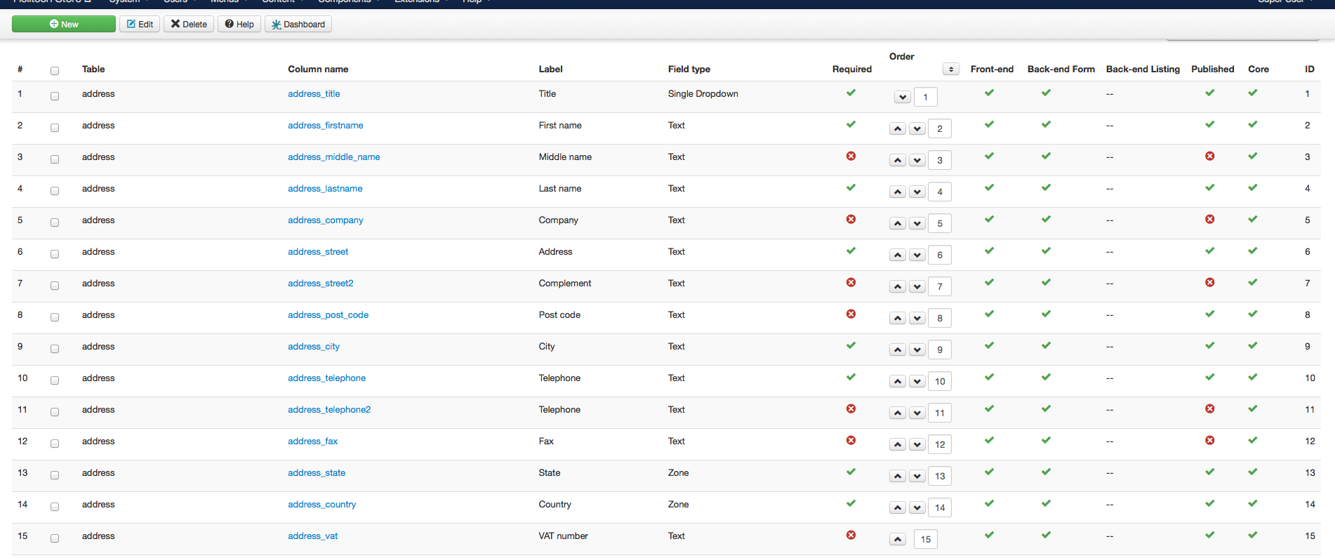

I've attached the screen shot as requested. AS far as i know no changes have bee made here other than publishing the VAT number field.

So that's totally normal that it doesn't work.
If you enter a VAT number, the system will know that you're a company with a VAT number.
However, if you don't enter a VAT number, the system will think that you're an individual since that's the default setting.
The system has no way of knowing if you're a company or an individual because the company field is not published.
So either you publish the company field (so that the system can differentiate between an individual and a company), or you change the default address type to "company without a VAT number".
