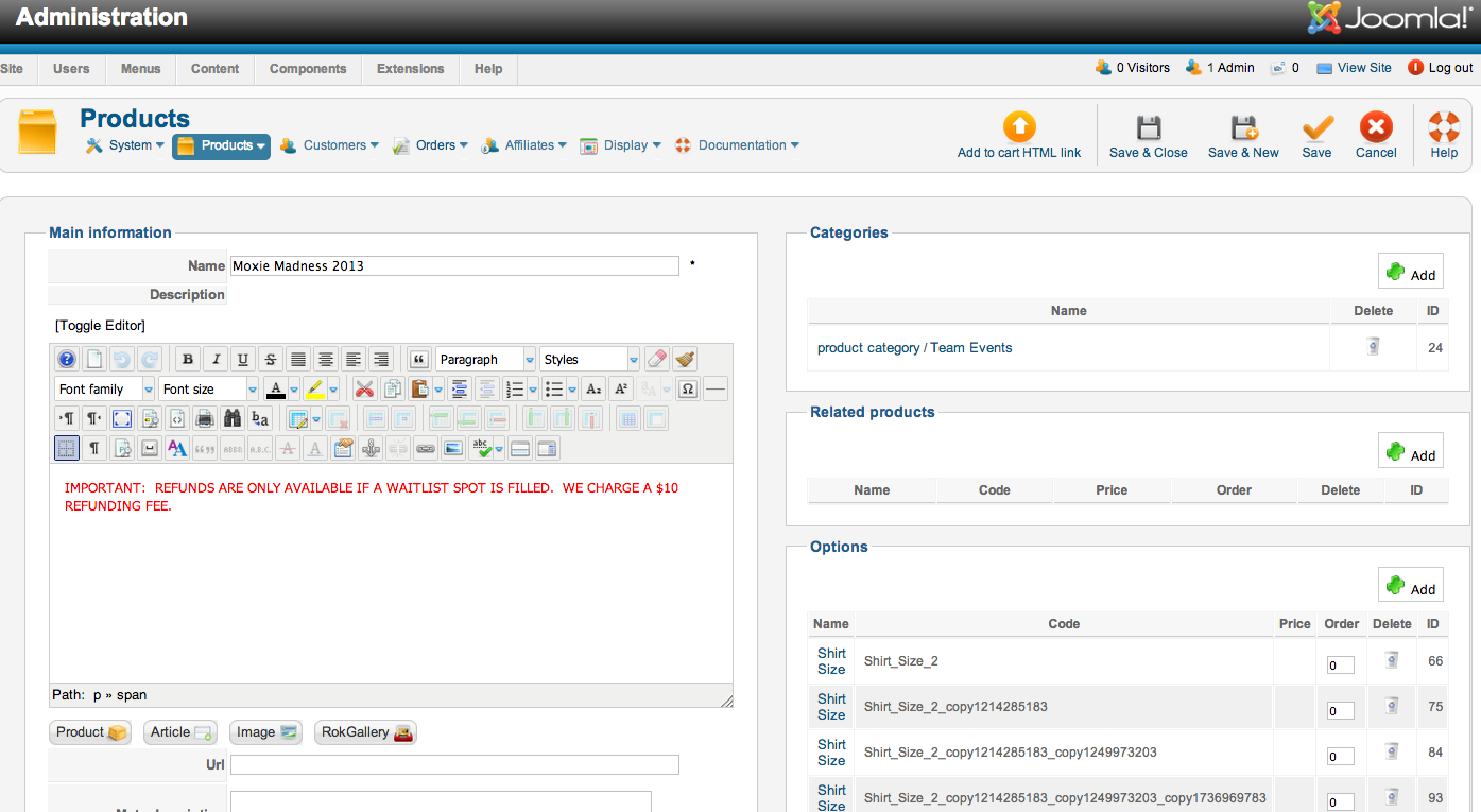

I have a event that "requires" buyers to select 4 tshirt sizes:
www.wodrocket.com/index.php?option=com_h...ct&task=show&cid=147

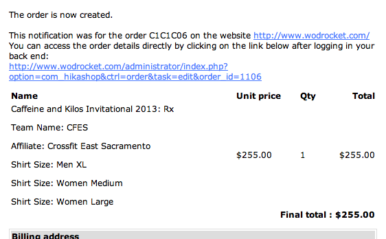

However today, I got a order with only 3 shirt sizes selected (screenshot)
What could have caused this?
  • Posts: 26386
  • Thank you received: 4078
13 years 2 months ago #112526
By default it works good but, when I made some tests, I have reached a product limitation so HikaShop removes some products option from the cart without touching the main product.
So the result was a product, with less options because the limitation for this product (which is an option in the cart) has been reached.
