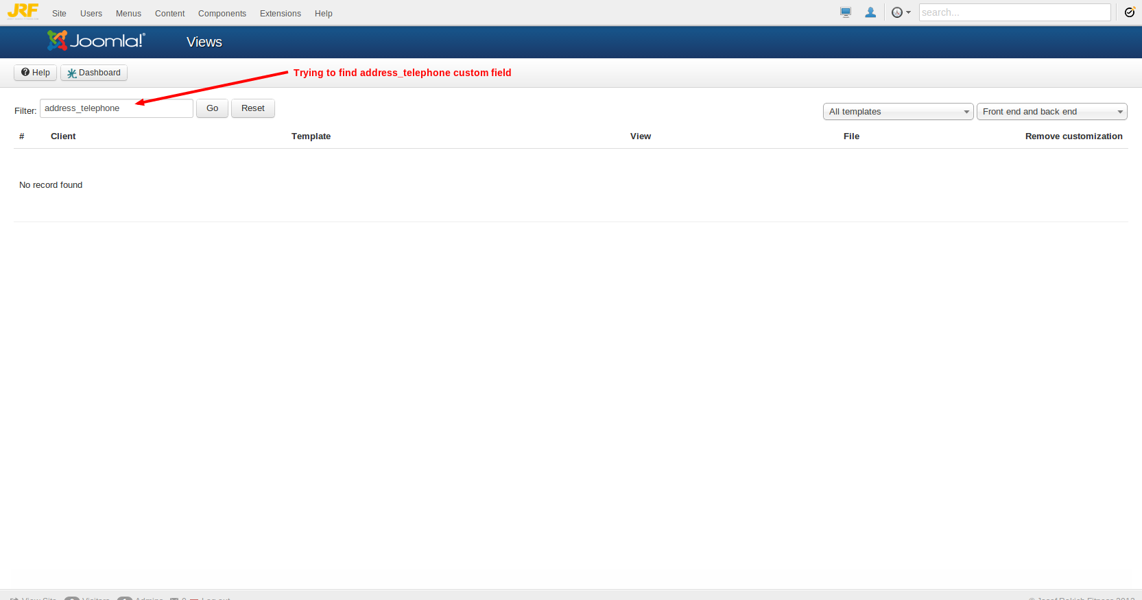

12 years 11 months ago #112734
Thanks for your help. I cannot see the menu item "Display > Custom Fields". Please see the screenshot for what I see:

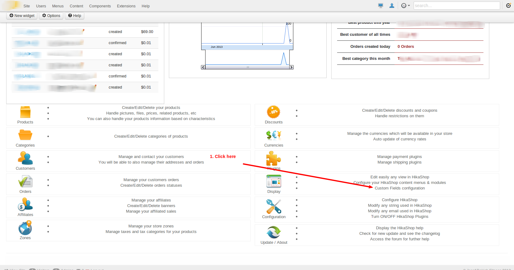

I was talking about Hikashop menu :)
Display is between "affiliates" and "documentation"

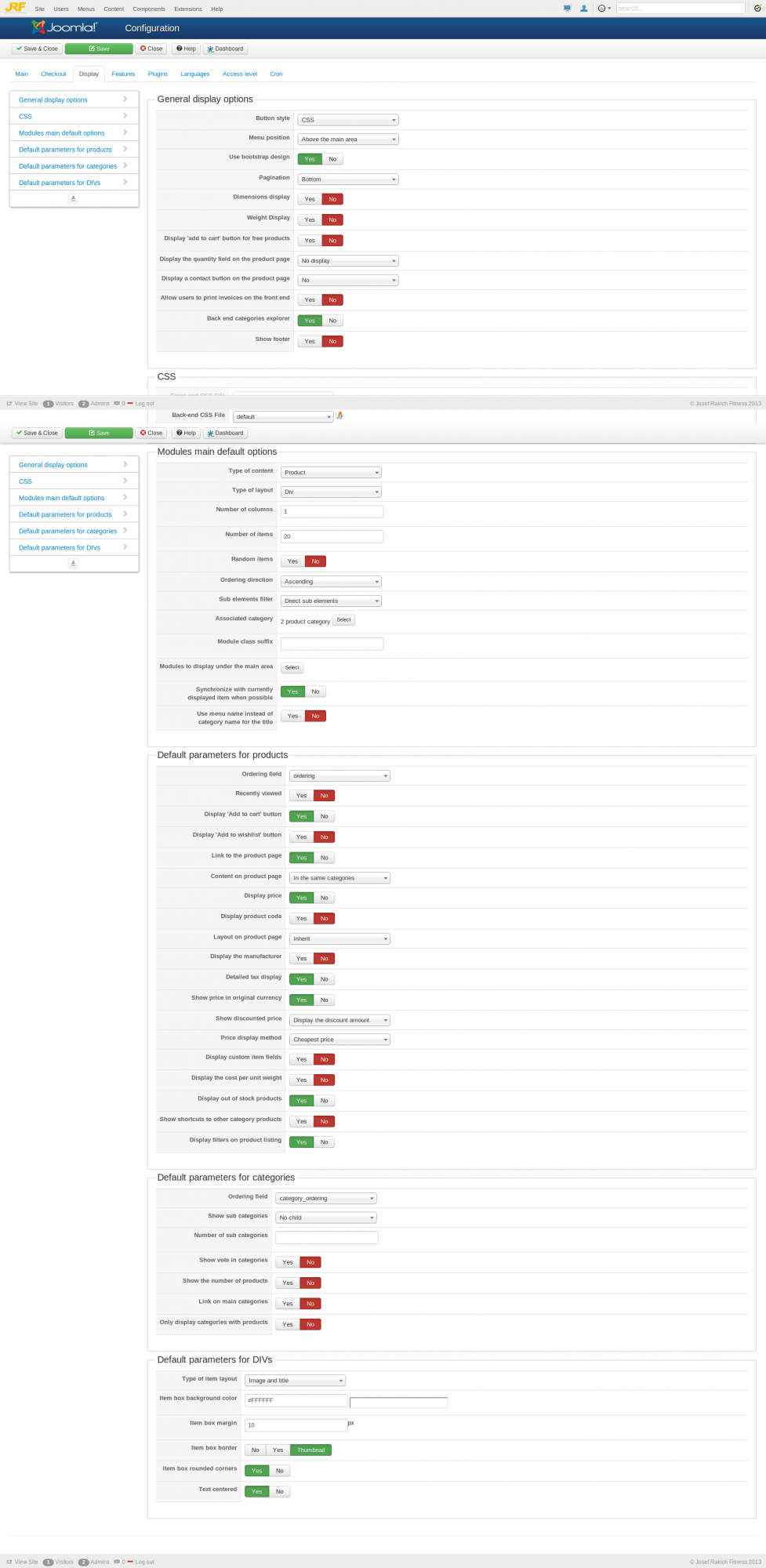

  • Posts: 15
12 years 11 months ago #113290
Thanks Eliot, I am still having trouble finding this. Please check the attached screenshots and give me further directions:
  • Posts: 2334
  • Thank you received: 403
12 years 11 months ago #113311
Here it is!
Attachment not found
