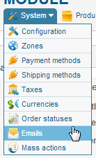

12 years 11 months ago #113046
You'll be able to do that through "Component->Hikashop->System->Emails" :

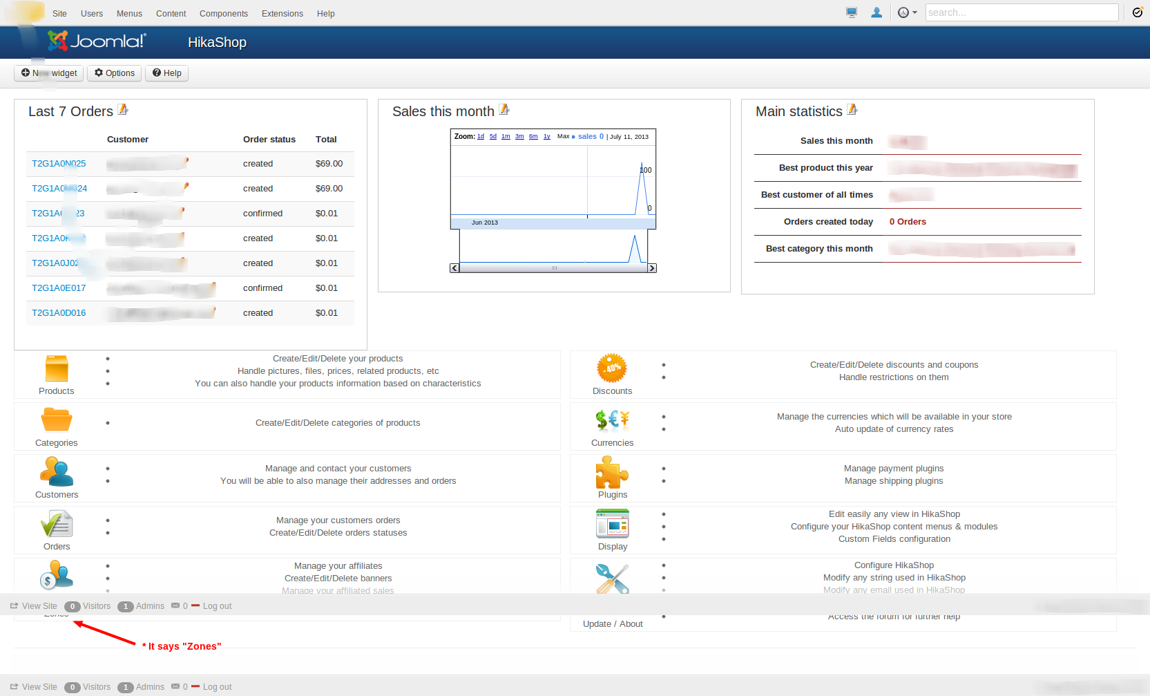

12 years 11 months ago #113292
I can't see this menu, please see the screenshot for what is visible in Joomla! 3.0 and Hikashop 2.1.0

12 years 11 months ago #113335
Can you scroll to the top of your page, and tell me if your have this toolbar :
If not can you change your back-end template and see if this toolbar is showing ?
Thanks.
