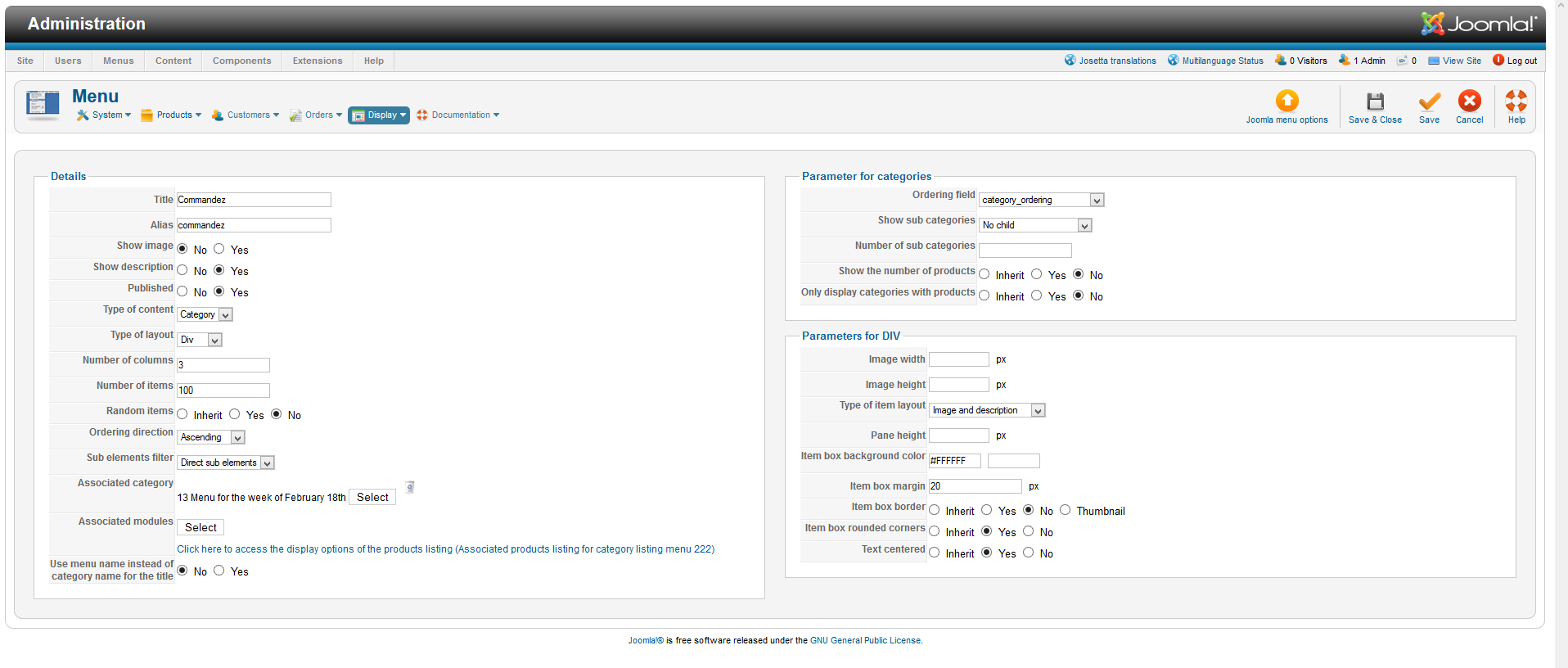

Here is my french menu item:

Your menu is a category listing menu. You have to check the configuration of the attached product listing module.
You can click on the link in the zone "associated modules".
The configuration that we want to check is here (in the module).
