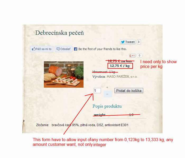

2. is really important for me, because that why I bought you product.
My customer will sell vegetables and meat, so I need to set up your product to be able to order any nominal weight for product for those it is set. Some od product will be set for Per unit, some of them Per KG and customer of eshop could add any nominal weight they want.
I also need the component to show only Price per KG at product listing screen for product which are to be sold by any weight www.biobox.sk/E-SHOP/categoria/25-cerstve-ovocie.html
and also show this at product detail page www.biobox.sk/E-SHOP/produkt/190-ribezle-z-trebostova.html
I need to have selection of kg, or part of it, instead of unit ammount.
I Google Internet and also your forum, but I did not find any instruction for that. Im not a programmer or coder, so I would like to get clear instruction for this kind of modification. Otherwise is you product inapplicable for purposes I expect.

AD2. I did exactly what you recommend but the result is notwhat I need.
The eshop have to be able for selected products to get orders base on customers requirement of any weight, If he want 0,222kg he input this ammount, if customer wants 2,345kg provide thsi number and system will count price based on weight input, calculated using price per kg.
I attached screenshot.
Thank you

Mayby i explain it wrong, but Im not interested in "decimal value for a quantity" but decimal value for weight. Or you treat it like the same for your eshop solution?
If it is possible only by code change, could you please help me, how other customers those use Hikashop are customizing it for selling product which could have any weight?
For example, customer wants to order only 0,7kg of meat and he want to select it exactly to his cart.
thank you

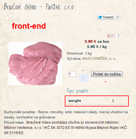

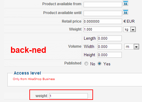

12 years 11 months ago #114192
I follow the instruction given by Nicolas "You can create a custom item field called "weight" via Display>custom fields and then install and publish that plugin and it should work automatically." and in front end i get one filed, as you can see on first attached screenshot called back-ned, when I provide the number in this field, in front-end it looks like on second screenshot called front-end
Is this what it should work like, or am I doing something wrong?
12 years 11 months ago #114249
Yes the custom fields work like that, you can hide it in frontend if you want.
Just toggle the button of frontend in the custom fields listing.

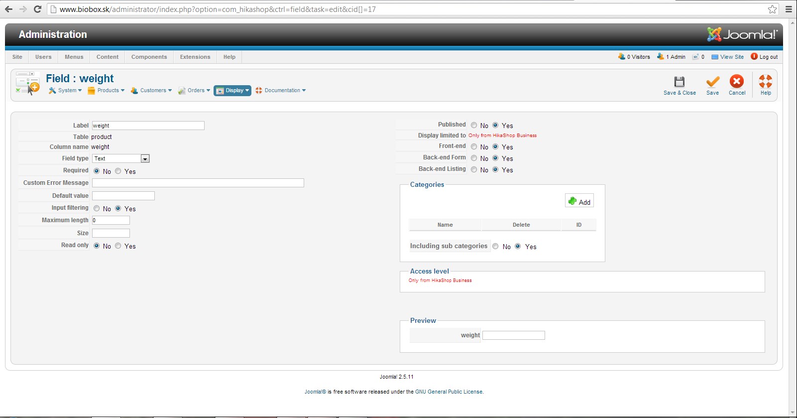

Can you show me how did you configured your "weight" custom field, trough "Hikashop->Display->Custom fields" ?
  • Posts: 36
12 years 11 months ago #114312
Hello
I made a screenshot of details of this Field, please see the attached file.
Thank you
Dominik
  • Posts: 26360
  • Thank you received: 4068
12 years 11 months ago #114412
As Nicolas said and as you said, we are talking about a "custom item field".
What you have configured is a "custom product field", not an item one.
Nicolas forget to mention that the custom item fields are available in the business edition of HikaShop, like the custom order fields.
