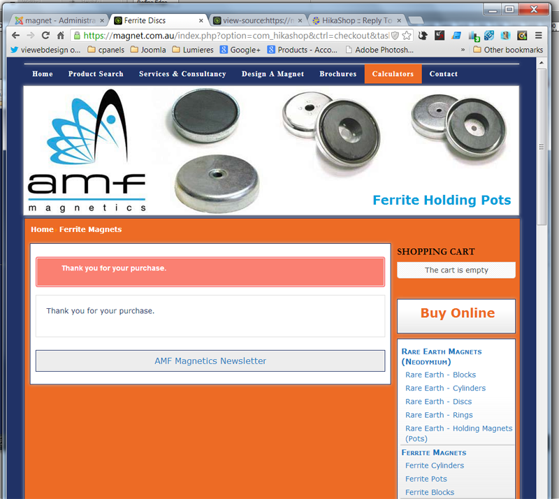

Attached is the thank page after payment (not sure if that tells us anything.)
Don't look at what is and ask 'why?'; look at what isn't and ask 'Why Not!'

13 years 2 months ago #113528
For eway, you have to edit the file "eway_thanks.php" in the eway plugin via ftp.
It don't use the standard HikaShop view.
