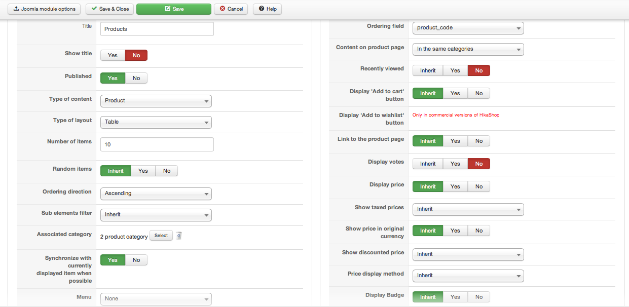

I checked and yes, it is enabled in the main configuration; and there is definitely more than 10 items!
The product list is enabled as a module displayed at the bottom of the page. A screenshot of the module from the 'content module' part of HikaShop is attached.

12 years 11 months ago #113548
There is no pagination for the modules.

  • Posts: 85789
  • Thank you received: 14081
12 years 11 months ago #113628
If your product listing module is attached to your category listing menu as an associated module, the pagination will be displayed. That is in fact the recommended setup of our documentation:
www.hikashop.com/en/support/documentatio...html#categories_menu
However, modules displayed by the template on specific template positions cannot have pagination.
Regarding the error, it means that in the "layout" option of your menu/module you selected "inherit". Please select "table" or "div" and it will work.
