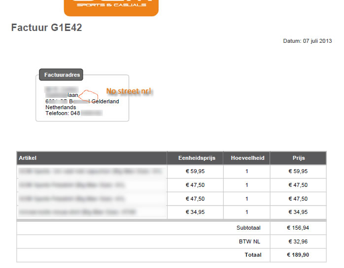

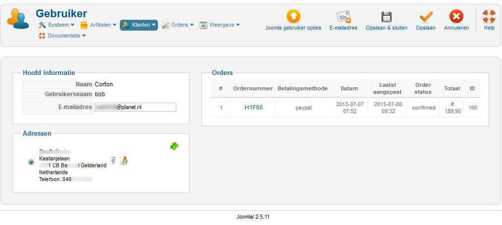

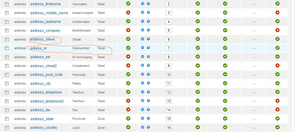

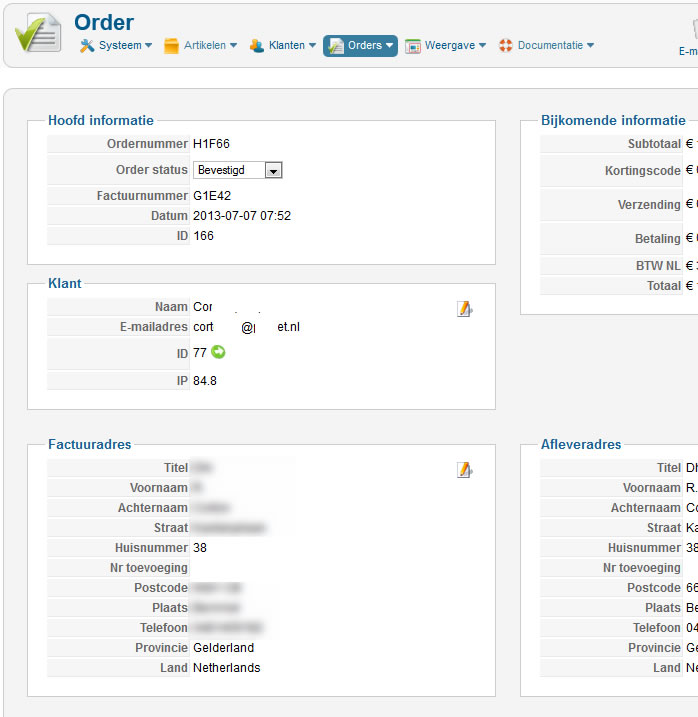

I use the PF invoices, but the extra fields are not on the invoice, see also examples.
I have added the fileds to the templates so that is not the problem.
Anybody any idea?
Adres NR Plus extension not there
Extra fiels I made(ndaddd to invoice_templates
Adres NR Plus extension ARE there
I'll keep on trying!

Hi there,
You will ned to edit the invoice.php file in plugins/hikashop/attachinvoice/attachinvoice to display these fields. Here are some elements of answer:http://www.hikashop.com/en/forum/4-how-to/69014-address2-and-custom-field-address3-not-on-invoic.html#69014
If you need any details or help, do not hesitate to ask ;).
