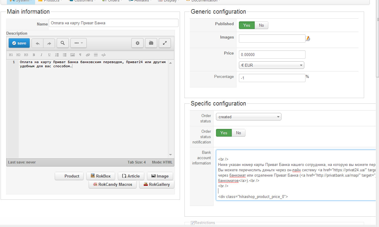

A screenshot of banktransfer plugin is attached hereto. Any mistake in its configuration from my side?

  • Posts: 120
