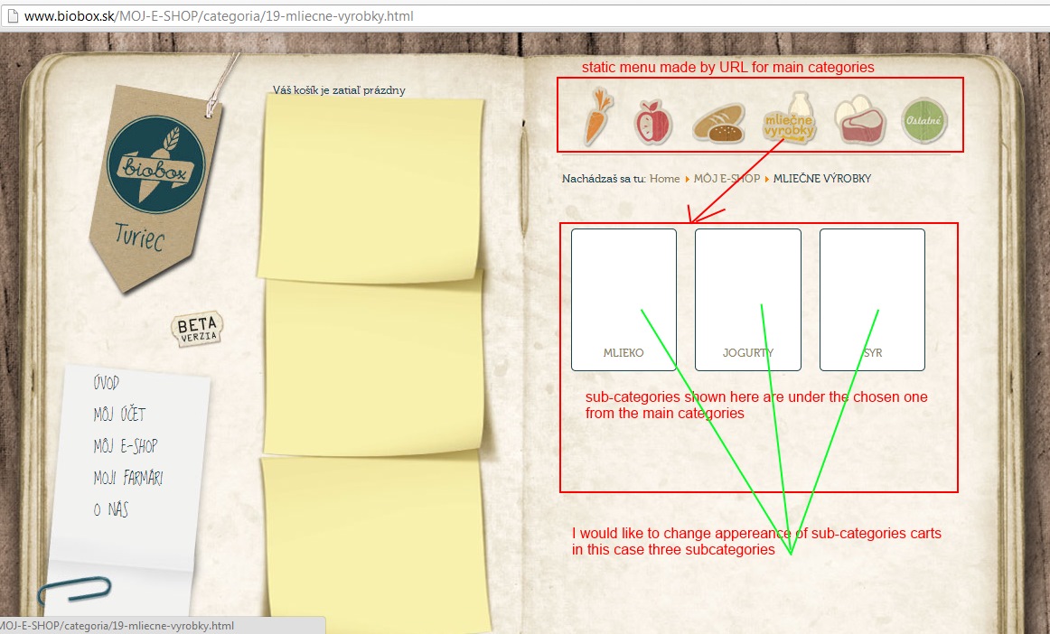

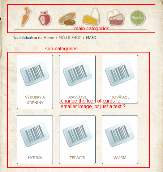

Could somebody navigate me please, if/how it is possible to change the style of sub-categeories (2nd level categories). It is any way to distinguish them?
As I marked it on the attached screenshot, at the top of is 1st level (main) categories and lower are sub-categories (2nd level).
thank you for every idea or instruction.
best regards
Dominik

The link to the page is www.biobox.sk/sk/

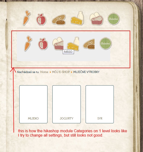

But first let me explain you the structure, if you take a look at the attached screenshot (screenshot no.1), you will see that the top left icon menu is hardcoded by URL, it is not dynamic. I try to use the hikashop categories module, but it doesnt work good and it looks very strange (see the screenshot no.2)
So the screenshot no.2 demonstrate how the hikashop builtin module looks like when I used it on my site.
Could you help me please?
thank you
regards
DOminik
