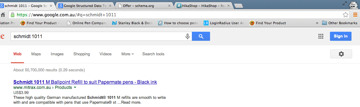

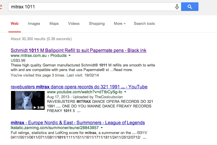

12 years 7 months ago #144921
Interesting this is what a screenshot from google.com.au
MItrax Trading
www.mitrax.com.au

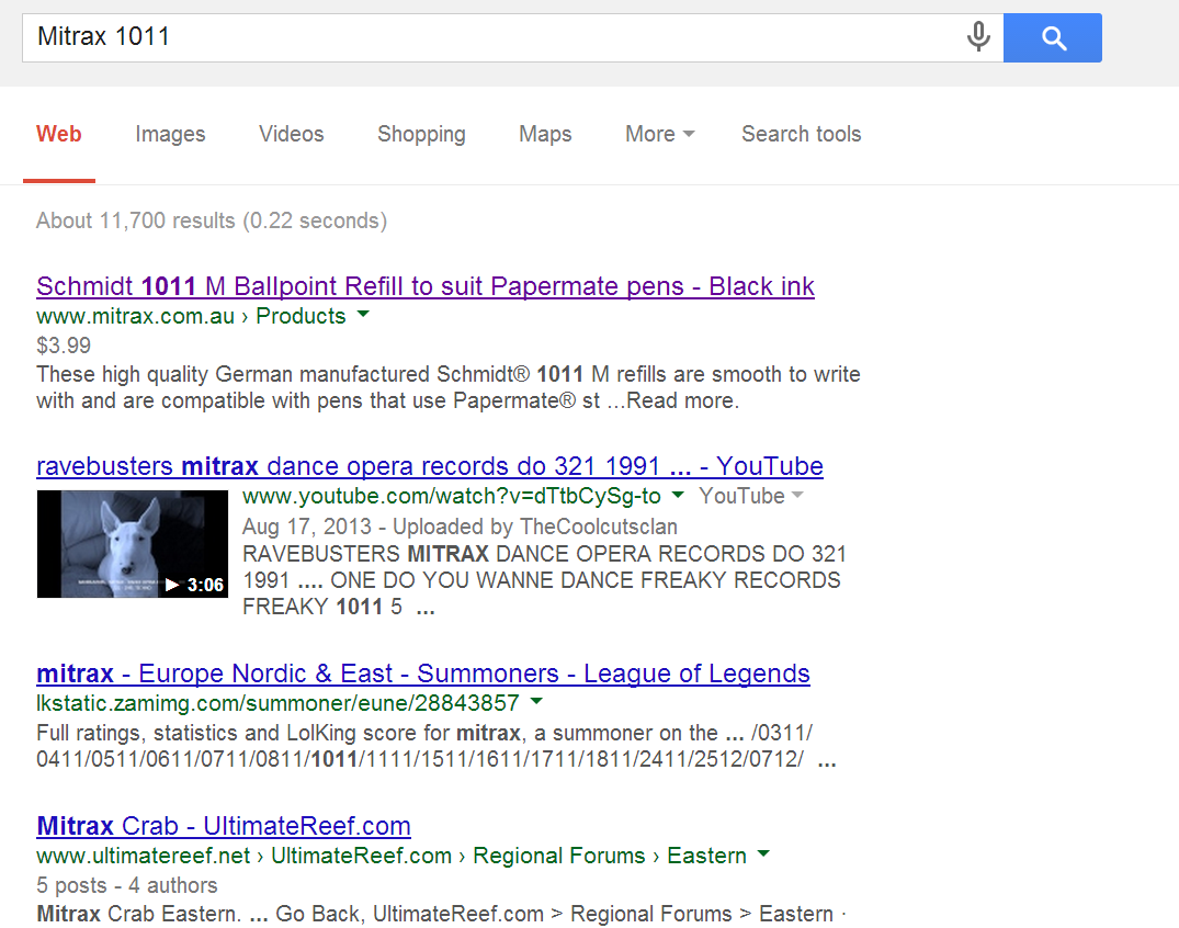

  • Posts: 76
  • Thank you received: 5
12 years 7 months ago #144922
Should I say this is what a screenshot from google.com.au looks like.
MItrax Trading
www.mitrax.com.au
  • Posts: 86212
  • Thank you received: 14220
12 years 7 months ago #144964
I do see it correctly on google.com.au regardless of whether I'm logged in my google account or not.
Can you try again in incognito mode (a browser mode for anonymous surfing) ? I guess that you should also see the price without the US in that case.
Google and its personalized results...
I guess that it's because you display your currency with the $ symbol. If you edit your currency settings to display the prices like that: AUD$ 9.99 or something similar, it should be able to display the price in AUD regardless of the user searching for the product.

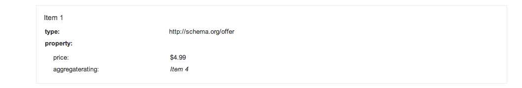

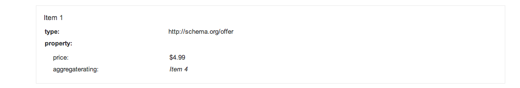

  • Posts: 76
12 years 7 months ago #145050
Thanks for working with me on this . Incognito makes no difference:
The google test tool shows the following:
Would adding pricecurrency into the snippet help ?

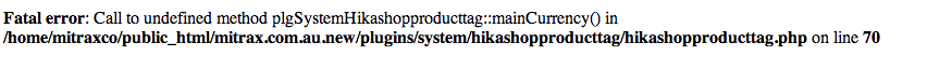

  • Posts: 76
12 years 7 months ago #145130
MItrax Trading
www.mitrax.com.au

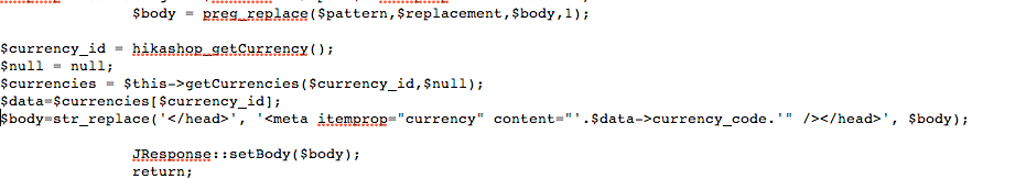

  • Posts: 76
12 years 7 months ago #145272
This is what I pasted into hikashopproducttag.php

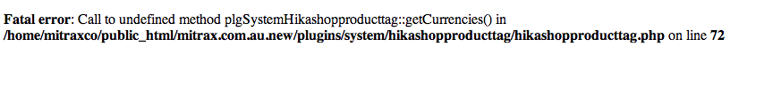

  • Posts: 26387
  • Thank you received: 4078
12 years 7 months ago #145342
It is logical that the plugin "hikashopproducttag" does not contain the function "getCurrencies".
I think it will be better if you call this function on this owner, the HikaShop currency class, like Nicolas wrote in his post.
You don't have to improvise you know, just to copy and past the code that Nicolas wrote for you :)

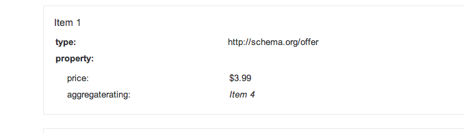

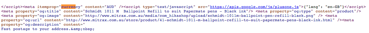

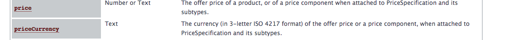

  • Posts: 76
12 years 6 months ago #145350
Jerome,
Thanks for pointing out the logic of the code in Hikashop I am pleased that I am in safe hands with someone who understands it as I can honestly say that I have no idea. As for improvising ... I guess I did to a degree i.e. I made an unintentional cut and paste error. :oops:
Complete code is now in and snippet is appearing in the metadata
but is not showing up in the google test tool. I changed the price to confirm the test tool was picking up changes.
Is it possible that the currency needs to be nested as a property of the offer before it can be picked up ?
Thanks in Advance.
