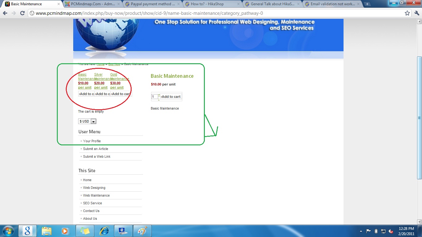

I reconfigured everything now the products show up.... but in a very random fashion...I want that products would show up category-wise.
secondly if you look at the image attached the red marked area....items are over lapping
Thirdly how can i bring the green marked area to main page instead of the menu area
Awaiting for any help

15 years 5 months ago #8635
The items are overlapping because there isn't enough space to display them properly in that area.
You should unpublish the hikashop cart module, the hikashop currency switcher and the module displaying the related products and then go in the config under the tab display and click on the select button of the option "Modules under the product page" and publish these modules there.
That way, they will be displayed below the product page and not on the left column of your template.
