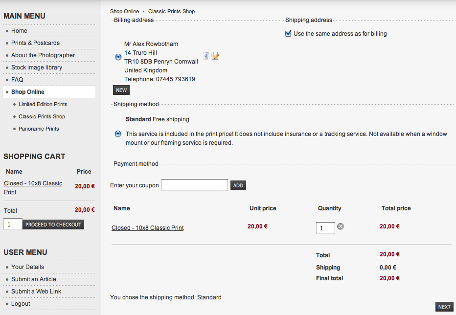

The figure in the cart module said 24.00 before clicking this link, after it changed to 20.00 but didn't add the new product. I can only deduce that this link is the problem and I shall remove it and refrain from using "add to cart" anywhere other than on the product pages themselves.
This link now removed. Cache cleared, logged out all sessions, cleared browser cache, closed and relaunched. The cart module on each page shows correctly 24.00 for 1 product but if I "proceed to cart" then it shows as 20.00 and the module then also shows 20.00.
Basically if you are logged into the front end then click on the "proceed to cart" button, you cancel any tax calculation. If you are not logged in it doesn't happen.

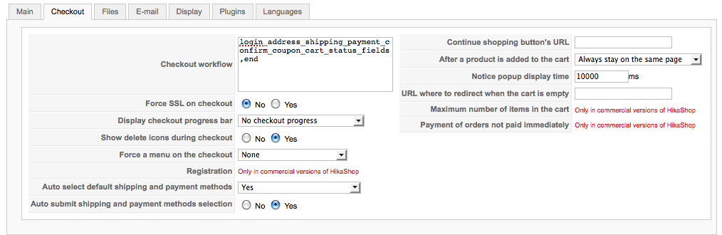

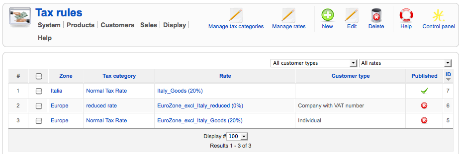

Could you do some screenshots so that we can see how you configured hikashop ?
A screenshot of your System->Taxation page, one of the main tab of your configuration and one of your checkout with your address and cart views.

Here you go, 1 of 4

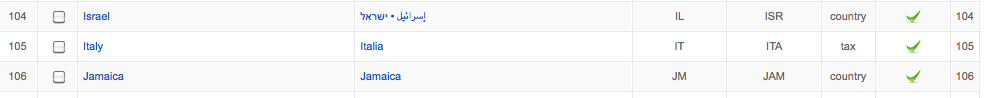

  • Posts: 87
15 years 5 months ago #8594
2 of 4

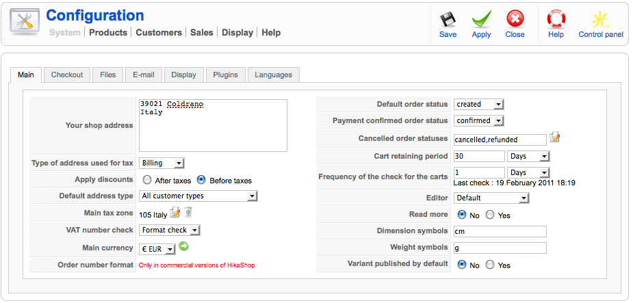

  • Posts: 87
15 years 5 months ago #8595
3 of 4

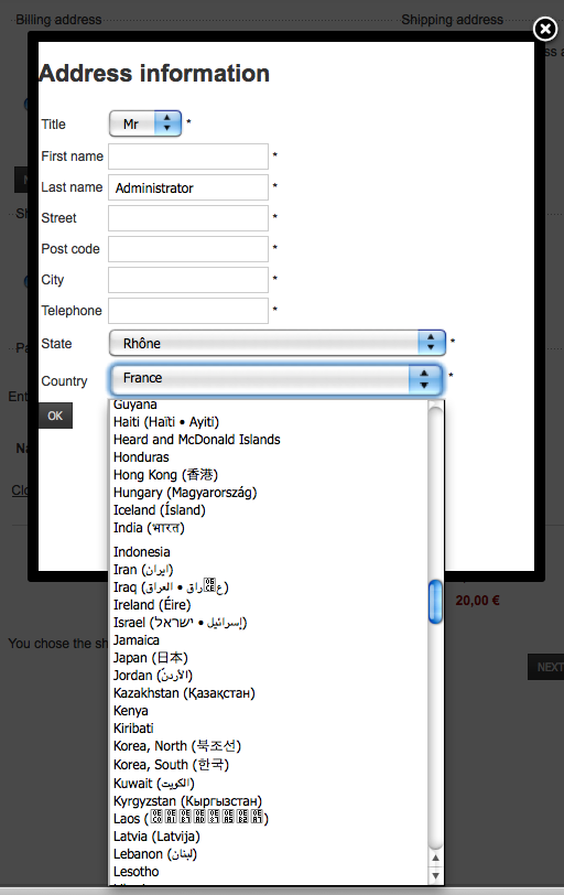

  • Posts: 87
15 years 5 months ago #8596
4 of 4

So, from your settings, here is what happens:
When you display prices before the checkout, the prices are displayed based on your tax zone being the main tax zone of your store (Italy) and since you have a tax rule for Italy,you have the prices displayed with the tax. Once you display the checkout, the zone of your address is taken into account by the system and you see the prices based on the tax in UK. Since you don't have any tax rule for UK, you don't see any tax applied on prices after that.

Ok, thanks for explaining that. I think I now understand what I have done (or not done) and to test this theory I am trying to register as a new user in Italy. However the drop down box in the form does not include Italy in the country list.

Could you go in the menu System->Zones menu and check that Italy is published ?
  • Posts: 87
15 years 5 months ago #8655
Yes it is.
  • Posts: 86042
  • Thank you received: 14175
15 years 5 months ago #8656
I see that you changed it's type to tax instead of country. Please put it back to country, otherwise, it won't be in the dropdown of countries...
