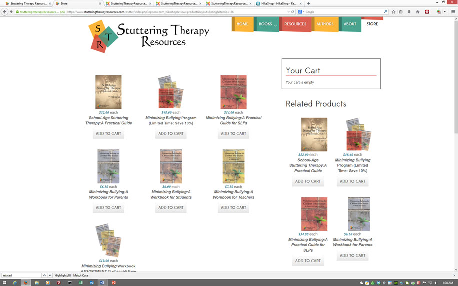

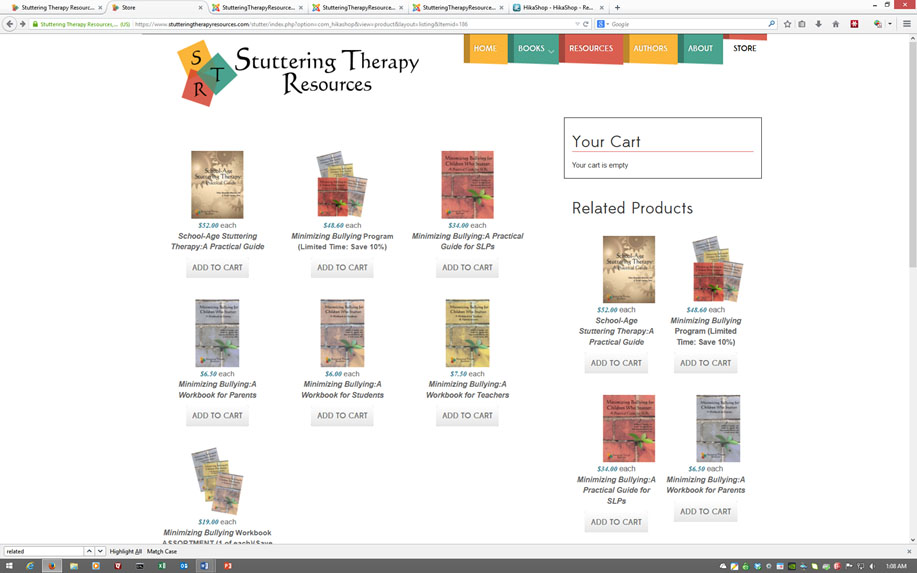

Hello - I was pleased to find this thread, because the original post outlined exactly what I wanted to do, and the response from Nicolas helped me do it - almost.
I am able to display the related products on the side (in my case, the right side) instead of below the main product list. When I enable this module, it shows on all pages, as Nicolas indicated. So, I restricted the pages through the advanced options to only the store. That's fine, too. It only shows up on the store pages (main store and products).
The problem is that on the main store page, where it lists all of my products (i only have 7 of them, so I'm not using categories), I also get the full list of other products under the related products heading. I don't want it to display then - I only want it to display when I'm actually looking at a product. I can't figure out how to make the related products list NOT show on the main store page, but then still show on the individual product pages.
I've attached a screen shot. The test website where I am playing with this is:
www.stutteringtherapyresources.com/stutt...t=listing&Itemid=186
I'll appreciate any help you can offer. Thanks!
Scott
Last edit: 12 years 1 month ago by jsyaruss. Reason: screen shot didn't attach

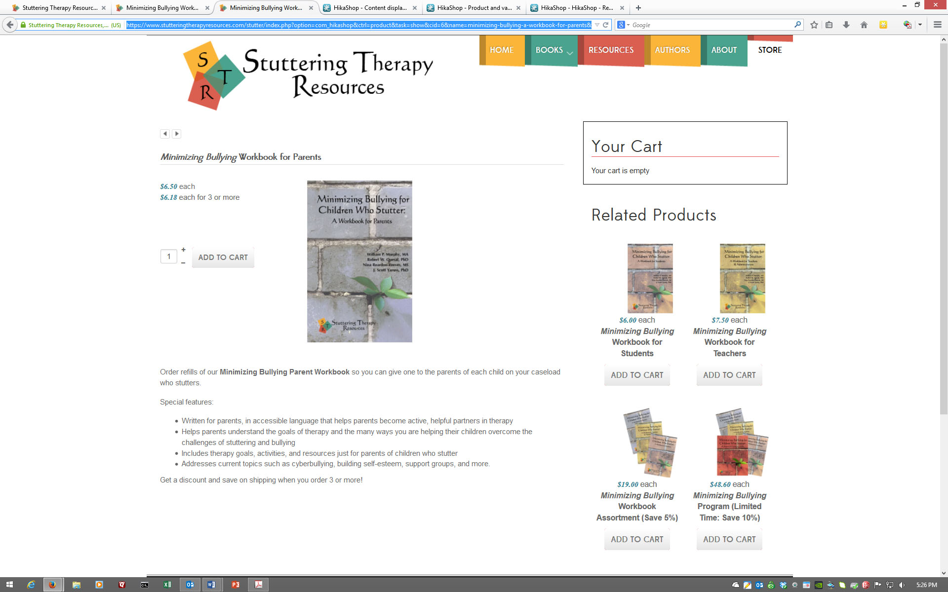

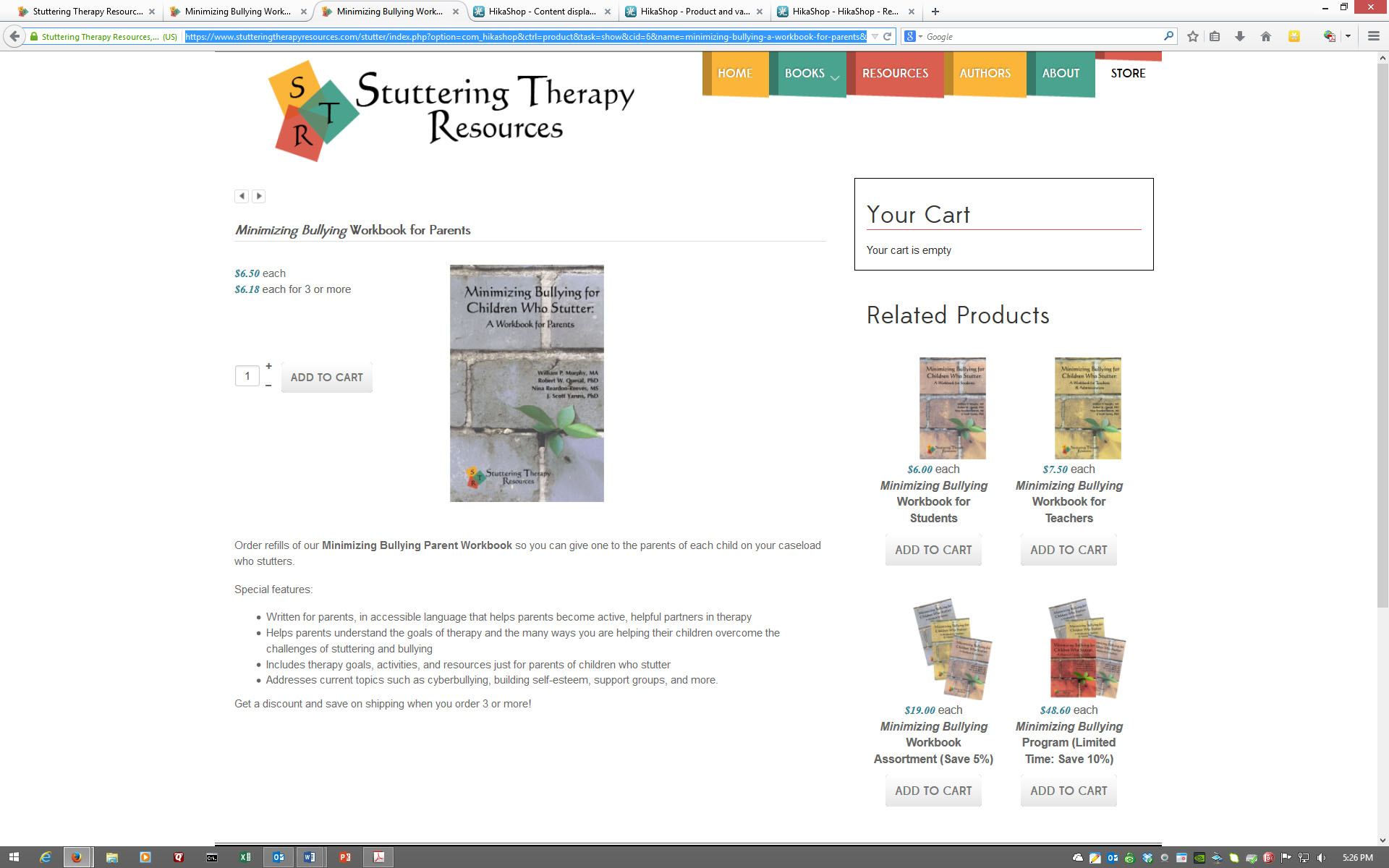

12 years 1 month ago #166190
An added complication (in addition to the issue raised above)...
When I select a book from the main store page, I get the related products to the right, just as I want.
If I select a book from one of the related products listings (or from anywhere else, e.g., a link in an article), however, the related products do not show up.
Is there some way to make the related products module activate in its new location for all of the products but not for anything else?
Thanks!
S

12 years 1 month ago #166226
From what you're describing it looks like a configuration issue of the module restrictions in Advanced Modules Manager.
I don't know very well Advanced Modules Manager, but wouldn't the "page types" option there allow you to display the module only on product pages and not on listings ? Otherwise, you can probably use the URL match option of Advanced Modules Manager so that the module displays only if the URL contains ctrl=product&task=show (which indicates that the current page is a product page).
But the best would actually be to contact the support of Advanced Modules Manager so that they can tell you exactly what setting you should use for the restriction so that it works like you want since they know their extension much better than us :)
The following user(s) said Thank You: jsyaruss

12 years 1 month ago #166314
Aaah. Excellent. I didn't have the advanced module manager installed...just the regular one. With the advanced, I get exactly the option you mentioned, and that solved the problem. Thank you for your help - i didn't realize that the issue was with the module manager and not with Hikashop (i'm a beginner). But, now all is well. Thank you!

12 years 1 month ago #166318
Thanks again for your help on moving the related products module. I've got that working just fine.
Only MINOR issue is that the related product figures are not centered any more. They're right-justified, I guess. Any suggestions on how to get them centered? (I see a way to change the text alignment, but not the picture.)
  • Posts: 86104
  • Thank you received: 14203
12 years 1 month ago #166355
I'm not sure why this is happening (apparently a conflict with some CSS of the template), but you can prevent that by adding such CSS code on your website:
#hikashop_module_187 .hikashop_product_image_subdiv{
margin-left: -25px !important;
