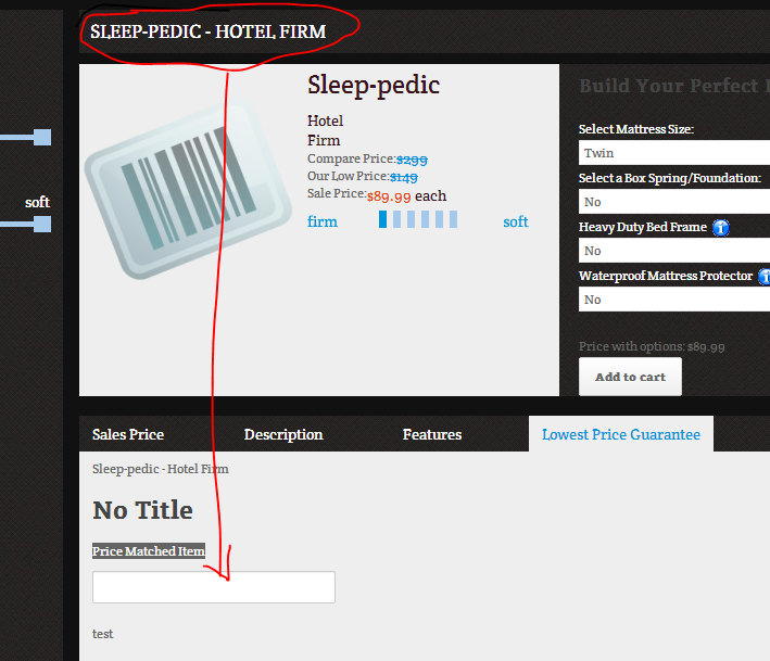

Hi I am still trying to figure this out. I just put this on hold for a while. Basically what I am trying to do is this:
I want to load the product_name which on this page is "SLEEP-PEDIC - HOTEL FIRM" as the default value for the form field called "price matched item". I attached an image to show you what I am talking about.
I want to do this on all my hikashop product pages. I want the product name to be loaded as the default value in the form for each page. By the way the form field called "price matched item" is a rsformpro field, which is where I want the product name.
I cannot figure out how to do this.
Thanks,
Josh

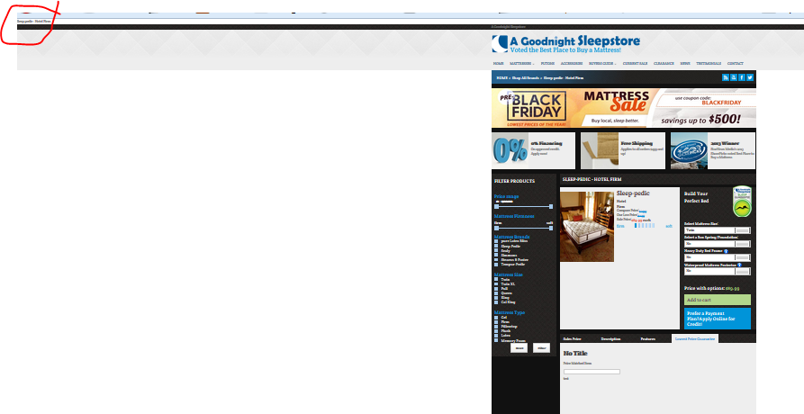

Thanks for the quick answer I attached a picture for you. It is still not working. Now it is doing something really weird. It is loading the variable into the page but not in the default form field. Even though I have this code in the form in the default value field it is throwing the product name at the top of my page above the header.
I inserted the code like this in the default field.
<?php
if(!defined('DS'))
define('DS', DIRECTORY_SEPARATOR);
if(!include_once(rtrim(JPATH_ADMINISTRATOR,DS).DS.'components'.DS.'com_hikashop'.DS.'helpers'.DS.'helper.php')) return true;
$id =hikashop_getCID('product_id');
$db = & JFactory::getDBO();
$query = 'SELECT product_name FROM #__hikashop_product WHERE product_id = ' . (int) $id;
$db->setQuery($query);
$product_name = $db->loadResult();
echo $product_name;
Also, I have my web developer toolkit and it is throwing the browser into quirks mode.
Josh
