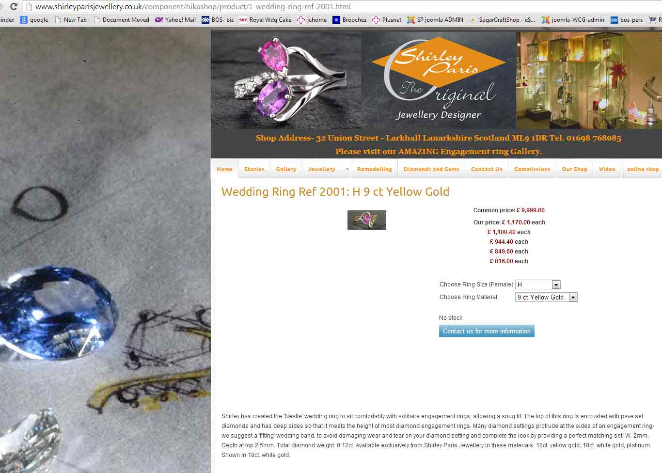

13 years 3 weeks ago #122137 by tombreen
thanks- now getting 'out of stock' message when testing the cart- we have approx. 50 products, mainly wedding and engagement rings. Each ring is available in 4-6 different materials, each a different price, also in a range of sizes, all made to order. However, trying to implement this, am getting out of stock when trying to select any size other than 'unknown'. Does hikashop create a 'product' for 6 materials and 20 ring sizes, eg 120 products? If so, can we control the stock levels so that the out of stock message does not appear? thanks...

13 years 3 weeks ago #122151 by nicolas
Yes, if you're using characteristics, a variant is generated for each combination. You can click on the "manage variants" button of your product when you edit it to access the list of its variants and configure the quantity of each variant.

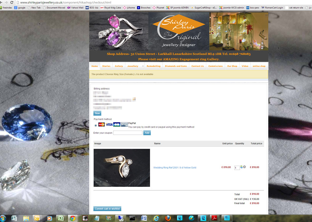

13 years 3 weeks ago #122218 by tombreen
Still struggling with the set-up of product materials/prices- now OK, and choosing size of ring. Now getting 'The product is not available' error when testing the purchase, despite the product stock set up as unlimited. screen shot attached...
More
13 years 3 weeks ago #122242 by nicolas
Since you probably don't have any price in your options, you must turn on the option "display add to cart button for free products" or the system won't allow you to add free options to the cart.

13 years 3 weeks ago #122247 by tombreen
thanks, that has fixed this problem now...
