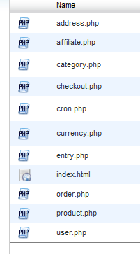

For the watermark, I could find the file with toggle on the end - have attached a snipping for you to see what is available. Tried doing a search for that line in cpanel, and nothing came up... :blink:
Thanks for your help :)

You're looking at the folder components/com_hikashop/controllers and not the folder administrator/components/com_hikashop/controllers

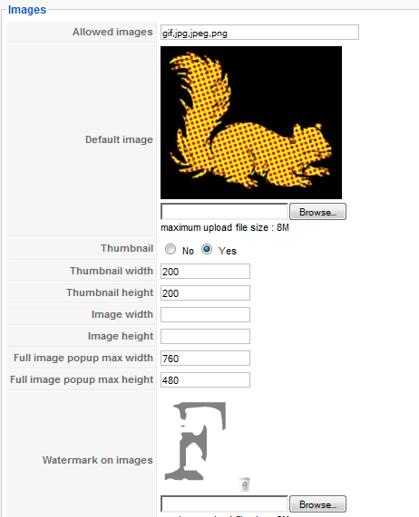

Could you make a screenshot of your options in the tab files of the configuration ?

Yep, please see attached :)

15 years 5 months ago #8716

I see that you still have your watermark. Did you try to remove it and upload images after ?
  • Posts: 392
15 years 5 months ago #8726
Yes, the watermark has gone from the pictures, but now when I try to upload new images, I get a blank square... :/

The watermark wasn't removed from your configuration. I removed it and it worked.
It seems that you have a problem with the GD library on your website which prevents HikaShop from processing the images.
