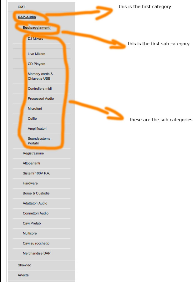

2. i need to nkow if is possible to setted one module to see more categories principal and after all sub categories just like this:
electronic
light
blue light
white light
i was searching but i founded and i was abled only this:
electronic
light
here category light's opening and showing his all sub catergories like "div".
i wound in left position his opening e in the same position showing sub categories:electronic
light
blue light
white light
just like screenshot
it is possible?
thank you
  • Posts: 124
12 years 6 months ago #143715
sorry, this is scrrenshot ok

  • Posts: 124
12 years 6 months ago #144064

2. If you want all categories to show, you'll just have to set the "Sub elements filter" option of your category listing content module to All sub elements.
  • Posts: 124
12 years 5 months ago #144840
hi,
2. i don't want to see all categories immediately,
i want to see principal category: electronic.
clikking on it, it's opening and showing sub categories: mixer, guitar ecc..
cliccking on one of these, it's opening and showin sub categorie one more time: mixer red, mixer yellow eccc.
and when i click on mixer yellow then it's opening his products.
12 years 5 months ago #144972
Ok, note that few accordion menus already exist for Hikashop like Skyline Nested Accordion or CKmenu. You'll find more information through that thread .
The following user(s) said Thank You: brain music
