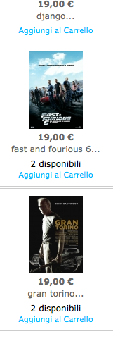

  • Posts: 124
12 years 7 months ago #136899
i added this code :
echo substr($this->row->product_name,0,46)."...";
but now i see every title with "..." with only 13 words too!
like screenshot. how can i don't see "..." in title under 46 words?
12 years 7 months ago #136953
1. The best solution will probably be to let your customers pay later through their order listing via their front-end user space, you'll be able to do that by enabling the Payment of orders not paid immediately through "Hikashop->System->Configuration->Main".
As it's said on the documentation :
Payment of orders not paid immediately : You can activate the payment of orders not paid via the listing of the orders of the user. He will have an additional button below the status of the order. Upon clicking on it, he will be redirected to the payment gateway in order to pay for the order. This option is available in all commercial versions of HikaShop.
2. By using this kind of code :
if(strlen($str) >= 46){
}else{
echo $this->row->product_name;
The following user(s) said Thank You: brain music
