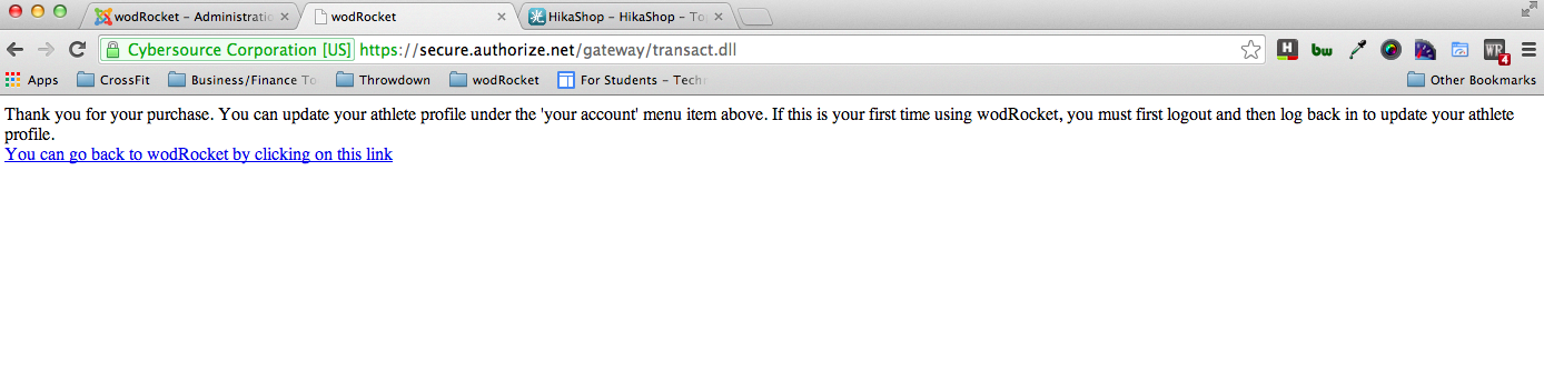

What code do i need to send users back to my site after finishing up with wodRocket. Older versions of HikaShop did this automatically and now the user is left with a white page in authorize.net (img)

There is already a code to redirect automatically to your website. There is no need to add anything.
Older versions of HikaShop indeed did this and the latest version of HikaShop still does that.
If it doesn't work on your website, it means that you must have a javascript error. You should look in your browser error console for the error message and deal with it.
I just tested with the latest version of HikaShop and it is still working fine.
