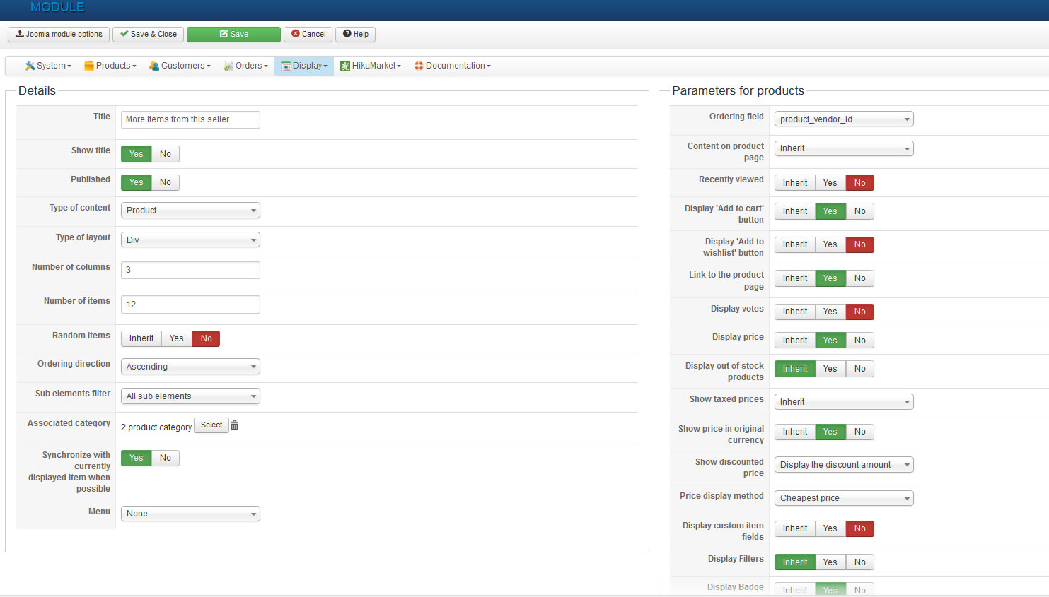

12 years 6 months ago #144796
I have hikamarket setup, and i would like a module to show more items from the seller underneath their products. I have created a module and set the 'Synchronize with currently
displayed item when possible ' i.e to sync with sellers other products, however other products are being shown. If it is not possible to show only from that seller is it possible to order them so that other sellers items are listed first?
Alex

12 years 6 months ago #144990
For your HikaMarket questions, please use the HikaMarket forum. It will be easier for me to be notified and answer it faster.
The option "synchronize" is used to synchronize with the current menu. If you are using a category menu, it will synchronize with the selected category and if you are using a vendor menu, it will synchronize with the selected vendor.
But if you are using a product menu, the module can't synchronize with the vendor.
At this moment we should add some new options in the module system in order to help the module to know with which information it should synchronize.
At this moment, we should improve the way that HikaShop manage the options of his modules or maybe create a new module into HikaMarket for this product listing. In both cases it should be analyzed and it can't be added in a short time.

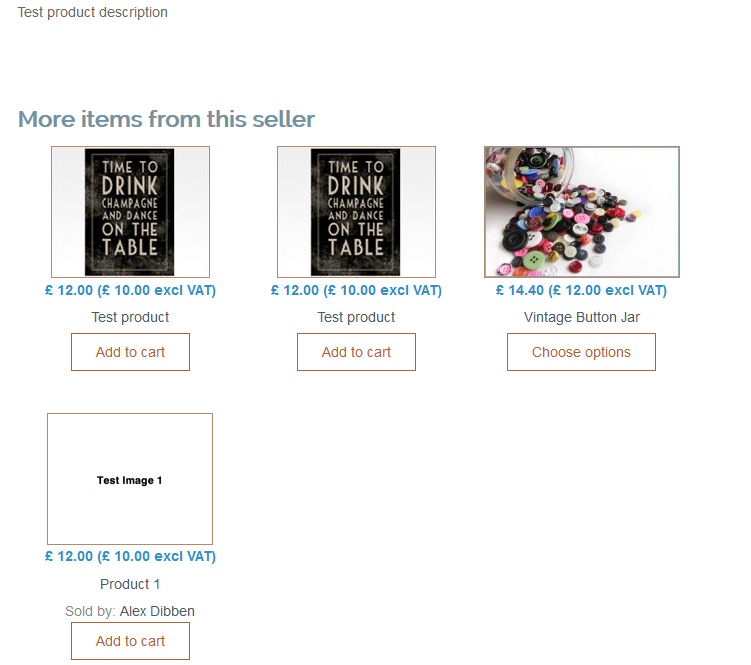

  • Posts: 377
  • Thank you received: 7
12 years 6 months ago #148270
I am not sure why it is not showing any of the vendors other products let alone another sellers products...
www.warestreetmarket.com/newsite/Artist/...y-victoria-penn.html
Do you know how it decides what a similar product is because i think the similar products we have showing don't really have any relation to the current product...
Alex
  • Posts: 26386
  • Thank you received: 4078
12 years 6 months ago #148289
Your configuration does not display the products of the same vendor.
To do that, you have to implement the feature thanks to a plugin, using the trigger explained in my previous post.
Your current configuration just use a special sorting on the vendor_id and display all products in all sub categories.
It can't have link with the current product until you implement it with the trigger.
